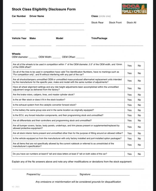

Yup that’s correct. Here’s the SCCA rules as far as I know (to say I’m a newbie is an understatement 😝)
