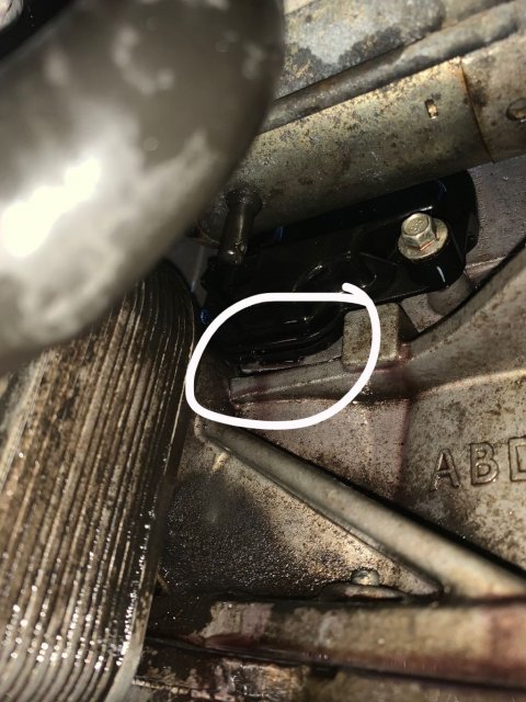

So after double checking everything and going through the ins and outs of what’s happening me and my friends found where I was leaking oil (the line was disconnected but it did get worse) I was told once I started smoking I’d be fine to make it back to my house since it was only 4 mins away which was a horrible mistake. We found a pinky sized hole in my engine block. Luckily I’m under warranty so I’m just crossing my fingers that they will fix it. IMG_0838.jpg
Xternali
14
13
Anchorage, AK, USA
Thread Starter #18
How much oil was on your dipstick before (I assume) you refilled?
I changed the filter then filled the oil tank all the way. When we drained the oil the first time and mind you like not even a shot cups worth came out. So when we filled it we changed the spark plugs and then tried to start it because it was ticking before. Once it started I just started pooling under the engine after we had secured the oil feed line.
