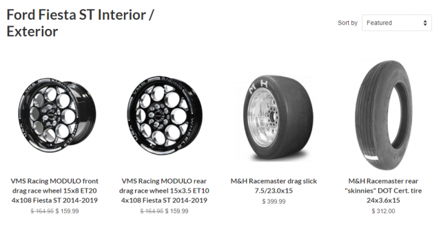

I'm looking for real world experience. Want a bias play slick. Being turbo would a 23 or 24" work better?
the set up on our site (pictured above) has gone high 10's at 129MPH on a fiesta st
tires have been the go to after trying a few different taller sizes on our sponsored car with whoosh hybrid (11.8 best ET) and now with the G-Serties 25-550 (11.5 best ET)
hope that helps

I looked with little success. For those that drag race what wheel/tire setup are you running? New to fwd at the drag strip, what tire pressures are you guys having success with?
Like Ron said above, you will want the 23x7.5x15 M&H drag slicks and whatever wheel you like. I am going to upgrade to the VMS wheels at some time this year. But for now I just have a cheap set of aluminum 4x108 wheels and they work well. I tried a 24.5x8x15 and it was way too much tire for the car. It killed a ton of ET and MPH.
