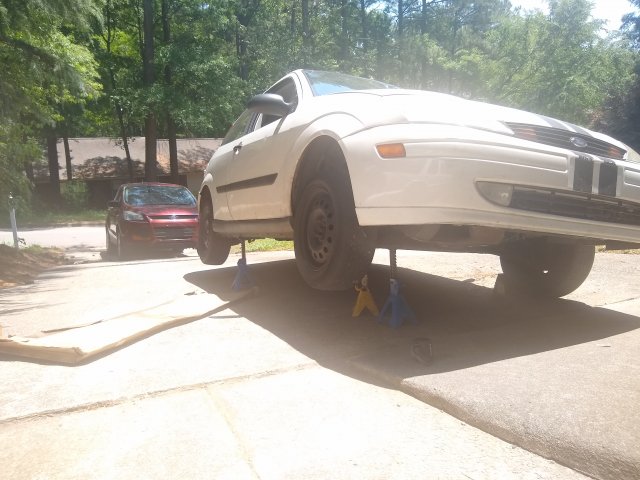

You could do what I'm going to try with my focus when I replace the cv, which is Jack up only one side, and hopefully get it high enough that no fluid comes out.
We'll see how it goes for me lol
Here's a picture of what I mean . . .
Kinda getto, but hey, if it works . . . Lol
