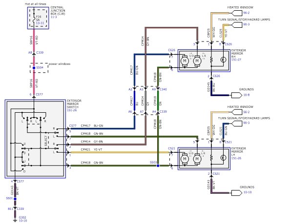

I would find it hard to believe that all the motors have failed in the mirror and I have been trying to connect a 12v supply directly to the mirror wiring connector to see if there is any life in the motors but Im not sure which wire is the ground / negative. I always thought Ford ground wires were black but googling different sites and information, it seems that ground wires are sometimes black and another colour. Does anyone have a link for the mirror wiring diagram or know what could be the problem ?

Thanks for the diagram. I will have to investigate this issue some more. Nothing is working in the mirror at all. The motors and lights are not working. I bought a second hand mirror but haven't had a chance to try it yet. I'm thinking this is a wiring problem.
