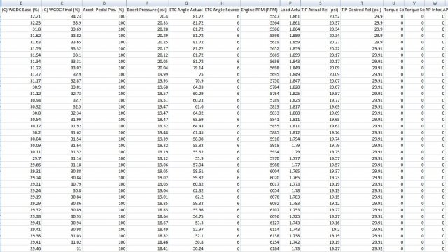

I can't find the source of the ETC cut at 5,757 RPM for the life of me, looks to be torque related. Attached a file (looks like .txt is the way to attach, sorry) - 4th gear pull on E30... ETC Angle Source is 6 which is torque related.
Nice delta between TIP actual TIP Desired -- Modified all the "Limiter Table" > "Torque Limits" to raise values to no effect except for the "Torque Reduction Ratio" sections which remained OTS, didn't modify Max Load at WOT and Closed WG series, tried both with CCF Torque Features on/off with no effect, Load limits at 3.0 and most torque clipping is over 400FT-LB.
Any ideas?? Runs perfect other than losing ETC starting at 5,700RMP, same every time.

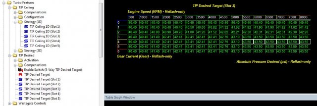

Here we go... and 1D Configuration for the TIP Ceiling us set BTW for the above... not quite 3 PSI delta as I've raised the TIP desired since it seems. TIP is probably the most common to cut ETC until the WGDC are set up but in this case it looks like Torque... or Load.... or Combustion pressures, or something else.

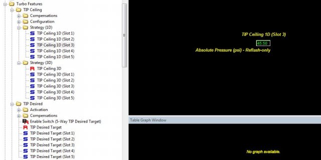

And you are using the toggles to enable the Cobb TIP ceiling override? You should have it enabled and strategy 0. I use strategy 1.

Thanks Jason, that makes sense... I did have the 5 way TIPC CCF strategy off as I was confusing it with using 3D TIPC... I will look at making sure Iā€™m eliminating the TIP ceiling for the ETC clipping, the TIP actual dips quite low... I was looking for OE load limiters as the source, there are million of them. ETC Angle Source monitor indicates Torque probably because it's not using the TIP Desired/Ceiling/Actial tables for ETC limiting strategy.

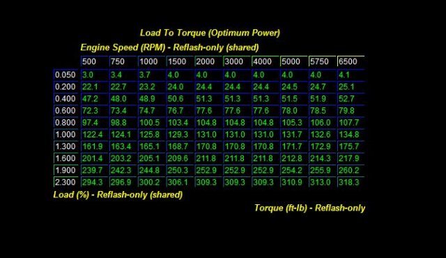

You need to raise the TTL to 2.450 all the way to 6500. The ecu interpolates the load between the cell values, so you are currently Load-limited.

I thought about trying something there, and I think it can be adressed that way... Seemed to me that the TTL-LTT was the ECU's formula or map for interpreting how much Torque was being produced so that it can build a complex torque based strategy, to say this much load at this much RPM equals this much torque... and if changing the values to lie about torque being produced, I would have to build the LTT to match to cover up the lie, or there will be an ECU error.
I discussed all the sources of ETC clipping with CCF with COBB and they told me the you can still run into ETC clipping issues if therer's a large disparity between load desired and load actual (torque as defined by the TTL is how I understand it). So that's what I was chasing. But now I think Jason is right, it's a very simple strategy switch issue for TIP Ceiling. We will see.

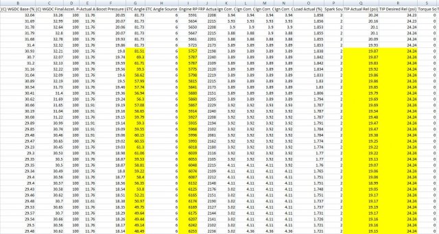

I'll keep digging, will try the TTL/LTT remap later FORZDA-2 when I have time to match up the LTT to show higher loads for the torque per RPM (if some excel guru has a pivot table of some sorts to do this, let me know), and will log some other stuff. There's something there letting off the gas, attached a screenshot of the last 4th gear log in case anyone is curious, hid some columns to declutter. Thanks for looking at my tuning challenge. :)

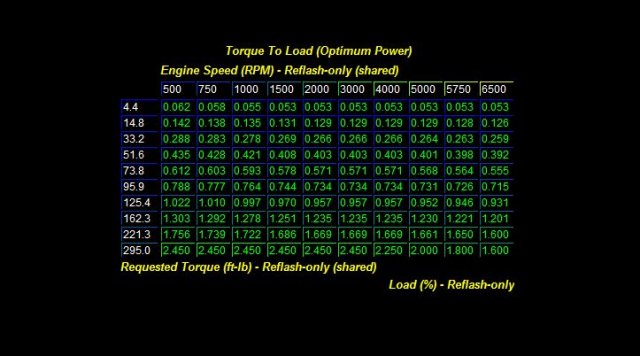

Youā€™re looking too deep, trying too hard to ā€œmatchā€ the TTL/LTT. Just raise the TTL in the last four cells to ~2.4 load and try again. The stock turbo canā€™t move enough air to keep the load up there, so the ETC will remain at WOT all the way. If the ecu thinks youā€™re too far off, it will set the code for ecu.

Update... tried many things (including upping the TTL cells temporarily), still the same situation... more details: datalogs for torque and load limits are out of the way, TIP Ceilings and Desireds are out of the way, torque source stays at 5.... load tapers from 2.0 to 1.0 at redline, TIP Actual tapers the same, all follow the ETC pulled back. Datalogged TQ and it's all reasonable. Hybrid Turbo so it will produce more load/tq/pressure without the ETC reductions above 5K ish.
1. CCF Torque Features -- Have this enabled (1), and TQ Max Tables either (0) or (1) no difference -- in Limiters section all TQ limits well above 400, TQ max tables well above 300 in this area, all TQ Min/Max are high, TQ reduction ratios are OTS based
2. CCF Turbo Features -- TIP Ceiling and TIP desired sections, I see no issues or limitations here, neither in settings nor in any datalogs, there's a nice big margin. Wastegate Controls -- Waste Gate Cannister Pressure 5 way disabled (using CCF WGDC, and I havent studied thes tables for the OE WG). WG Base (1) enabled with X Axis MAP, WG Compensation Mode enabled (1) and all settings are (3) but also tried (4) which could cause issues but same result, and back to (3). CCF Master On (1) of course.
3. All CCF items like launch control, flatfoot shifting, torque control, are turned off.
If anyone takes the time to read these details and think about how/why the TQ may be pulling ETC, I thank you.
