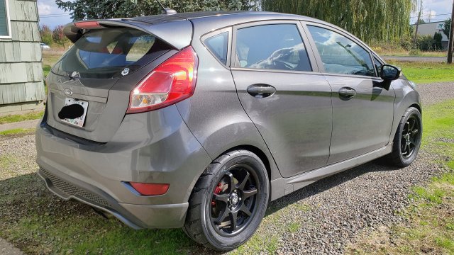

here is the picture of the guy running 245/45R16s, this is 24.7" tall. This is an R888 tire, Tirerack says this tire is 24.6", so maybe its a little small for its size. Tread width 8.5", sect. width 9.6".
Owner says he has been running this tire for about a year with minimal rubbing. Stock suspension, typical offset 7" wheels (43mm is my guess).

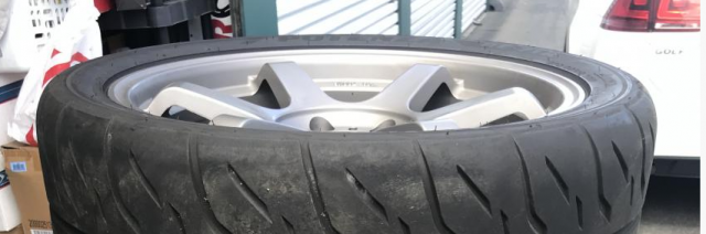

There also comes a point where you are going backwards in performance by putting a much too wide tire on a way too narrow wheel (as much as I HATE excessive stretch, way too little is even worse for performance [wink]).
More tire pressure will only make up for so much in this case.
One may even run into the scenario where installers (unless you 'know the owner', or DIY) will REFUSE to put a 245 section tire onto an H/Street legal 7" wide wheel (whether 16" or 17" diameter), like I encountered trying to put a 205/50 onto an 8' wide wheel. [:(]

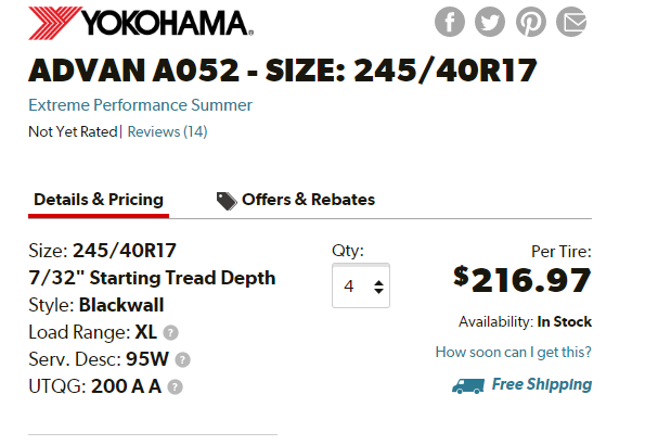

That all being said, the only competitive H/Street legal by tread wear tire I've seen in a 245/45-16 (you originally were saying a 245/40-17) is the Yok A052, which many claim needs ridiculous, totally not obtainable in H/Street trim, high negative camber levels to work properly on this car.
I agree, its a terrible idea, nobody should ever try something unless everyone else has proven it already works.
Mark Skroggs definitely didn't pinch a 275 on an 8.5" rim and win nationals with it, nope definitely a loosing idea.
Definitely don't try this out, and I will see you all at nationals next year... ;-)
