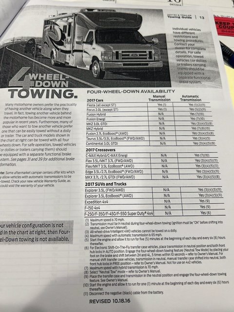

Thank you everyone- I appreciate your help immensely. I wish I could get straightforward answers on flat towing from Ford. I just spoke to my Ford dealer and he sent me a tow guide that specifically says all Ford Fiesta's (except ST) can be flat towed. He can not explain to me why though. This is the nightmare for me. Why can all Ford Fiesta's (even automatic transmission) be flat towed except the ST??? I did see one link on this forum that states he flat towed his Fiesta ST without difficulty. Does anyone else have this experience?
Can you post this?"
I have the 2015-2016 WRECKER TOWING MANUAL and I cannot find such information.
Also, why would the Fiesta Owner's Manuel say that you CAN flat tow.
Why not ask your dealer about that?

See post above. I agree the manual says manual transmission Ford Fiesta can flat tow. But my Ford dealer who I have known for 15 years says no. Thank you everyone so far. As you can see there is not one consistent answer.

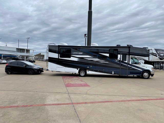

I have been flat towing my Fiesta ST for about two years with no issues. I think it is a great vehicle to flat tow. it is light behind the RV and fun to drive at my destinations. The nice thing about flat towing is you dont need a dolly or trailer or anything. Just unhook the towbar when you get to your destination and you are good to go.

Can you even see the fiesta in your mirrors? LOL
