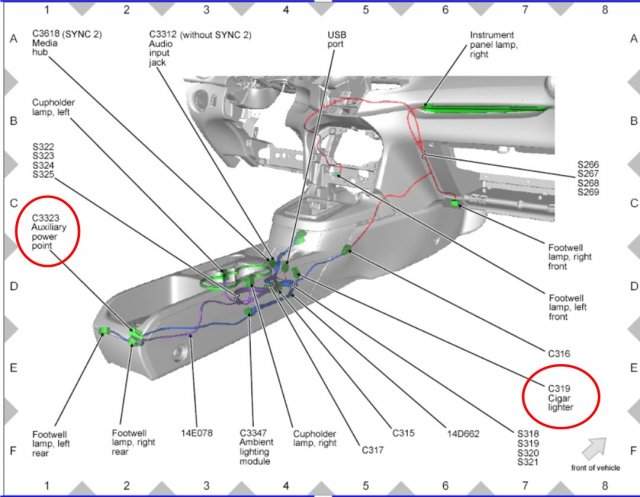

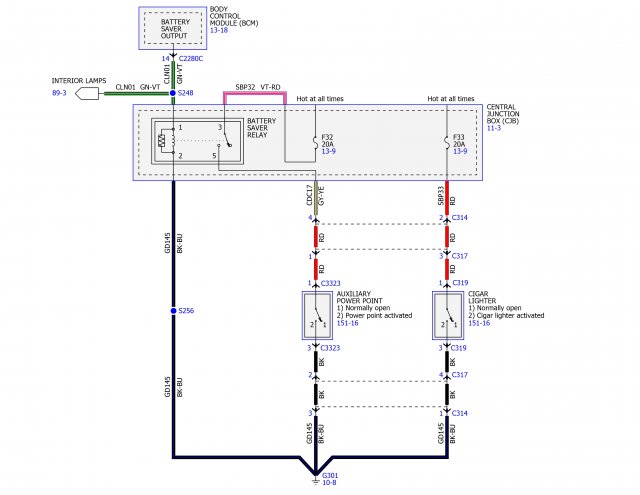

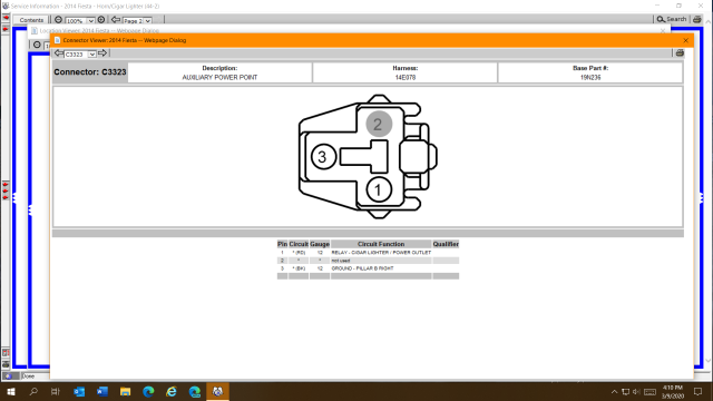

Yes, different markets.
Mine is fusees # 32 & 33
The main power point is in the front of the center console.
The aux-power point is in the rear of the center console.
Try using a test light in in each of the power points and remove the fuses one at a time to see what the fuses control.

Because of different markets, your connector or wire colors may not be the same.
