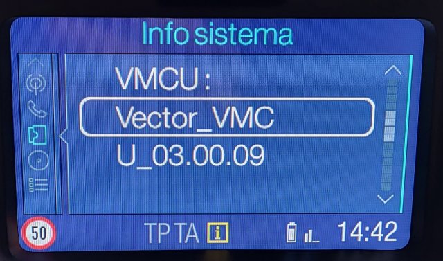

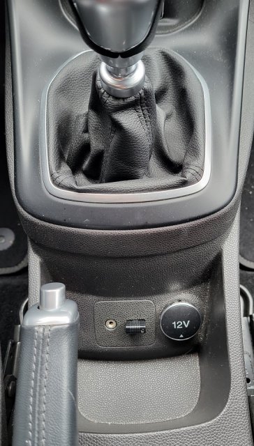

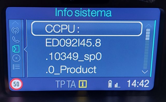

Ciao to all my fellow FiST brothers, I'm in need for your expertise and suggestions about what is the best way to have android auto in my car: sync to sync 3 upgrade or install an android head unit?
I've seen on Aliexpress a lot of Android Head Unit for Fiesta but in the description everyone say that they are not compatible with Sony unit. Is that about the cunbus of the Sony unit not fully decoded?
I would like to keep my wheel buttons and alerts from the cars working too.
Since I live in Italy, do you know someone who sell eventually some sync1 to sync3 upgrade kit?
Thanks

Ciao pakko yoy can go either way android unit or Sync3 unit. Firt I will recommend you to watch the YouTube channel NaviUpgrade this dude made an upgrades from Sync 1 a Sync 2 to Sync 3. This is that you get an idea of what you will need. The unit listed at Aliexpress are compatible with ford cars around the world, the important is that the version of the Sync if has navigation you download the proper map zone for your case EU. The other thing you required is the touch screen size your car will support, in you case because you have Sync 1 you need the cover. I do not see clearly the screen size you have. Any way the second thing is the size in storage of the APIM for navigation you need 64 Gb for EU map none navigation 32Gb finally you can ask the seller at Aliexpress he will reply to your qdoubt. Keep in mind the time zone. The last thing is the connector that will go to the APIM to the car and the USB Hub. All thos kits come with the antenna. Hope this will help you on your journey to upgrade.
