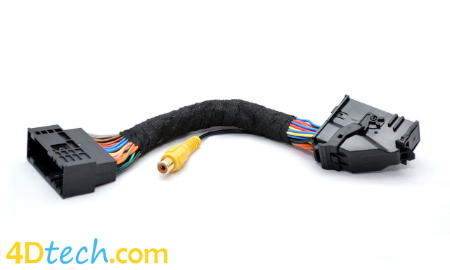

Put this adapter in between the original harness and the head unit: https://www.ebay.com/itm/3638647437...HLOC2lJrQp-&var=&widget_ver=artemis&media=SMS
Splice the original rca connection to the wire you ran and connect that to the female rca on the new adapter.

So with the adapter you don’t have to use the Metripack connectors right? So where does the ground wire connect too if using the adapter or is it not needed anymore?
Bull Run
U.S. Army Veteran
277
492
Chandler, AZ, USA
That's correct, I ended up using this from 4Dtech.com. I just used a ground point near the camera in the rear.
