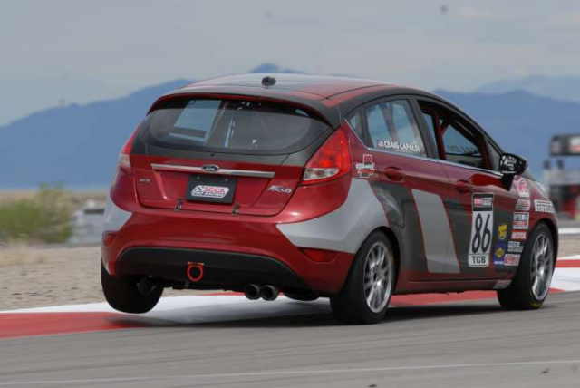

Look at the B-Spec race cars. They arent ST's and are fun as hell on track. Dont let people discourage you because it isnt an ST. The b-spec racers had a basic intake and catback exhaust for power mods, everything else was chassis, suspension and brake related.
They can still haul the mail with a proper driver(GET SEAT TIME ON TRACK) and a properly setup car.
Those guys can get down.

I still think an SE or SFE with a manual would be a great starting track car.
Throw Bilstein B14's on it, rear sway bar and a FiST rear torsion beam/disc brakes.
Then basic intake, exhaust and a 93 octane tune.
Finish with 15x7's and 205/50R15s in a 200 treadwear tire.
All other money goes into track events. Its a near perfect recipie for a FWD Miata-esq track car.
