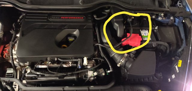

@STeve it's definitely not electrical smell. It's some kind of oil/rubber smell. I'm not sure if i can smell it with the windows open but I can definitely smell it when i pop open the hood and expose engine bay. The smell comes from the right hand top side I've added a picture of the engine and circled in yellow where the smell comes from. That's the turbo right?

The turbo is usually near the exhaust manifold as it uses the exhaust to generate its forced induction power. That area you are referring to looks like the battery and Master cylinder/clutch area also.

Oh okay thanks for pointing that out... So yeah I guess this all isn't very normal and I should get back to the dealer and ask for a thorough examination?

Everything you point to sounds exactly like the lovely smell of brake fluid being burned. It takes a long time to burn off too. Brake fluid is a hard to describe smell. It's like a dirty mineral oil smell - kinda smells like rubber just weirder and worse. Sorry - very hard to describe. Look for leaks around the master cylinder or brake fluid reservoir. The oil is very translucent in color - very hard to see where it drips. You could take brake cleaner and just spray down that whole area and see if it fixes it. Did you get any service done recently?

@EKFiestaST thanks for the reply. I'm afraid I'm not a very technical guy, I don't know where the master cylinder is even at lol. Well the car is only one month old so no service has been done on it yet, HOWEVER i went in at the dealer when I got up to 500 miles for a quick check up and all was fine the mechanics said. I then took the car back in for a check one week ago ( now at 1200) miles to complain about the smell a mechanic looked at the engine bay for a while with lights etc and they hooked it up to computer to check for errors and everything turned out fine. The mechanic said it could be smelling because the car is new and crap has to burn off but i don't think that is the case anymore because i can localise the smell very well ( see picture ) and it smells really hard.
