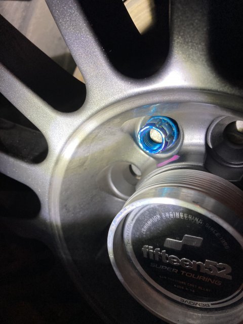

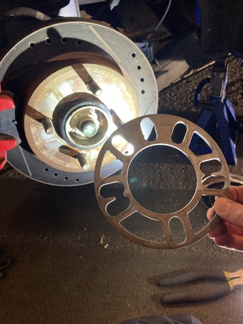

Hi all, enjoying a new to me 2015 fist. I was putting Bilsteins in the back yesterday and noticed the previous owner had added spacers with the fifteen52 podium rims. Looks like the rims have a +42 mm offset. I’m not sure what the spacer width is - need to go in with a caliper next time.
Wondering if I can get rid of these cheap spacers as the amount of grab for the lugs is very limited and honestly a bit worrisome. Thanks!

All of the 1552s are 17x7.5et42 and do not need spacers of any kind. I'm on my second set and they fit great. I've also run them with and without hub rings and haven't found there to be any difference.

Whether or not you want to get rid of them is up to you. It's all about the look! This place https://www.motorsport-tech.com sells custom spacers; folks on the forum including myself have purchased from them. They recommend 6-8 full turns after the threads are engaged to ensure proper hardware engagement. Hope this helps!

Great - I was hoping I could take off the spacers, and it seems to make sense that I could given the 1552 offset v stock - good to know it will work fine.
Good to know - I'll count my turns tonight with them on, otherwise I'm taking them off (though they do look good...)
