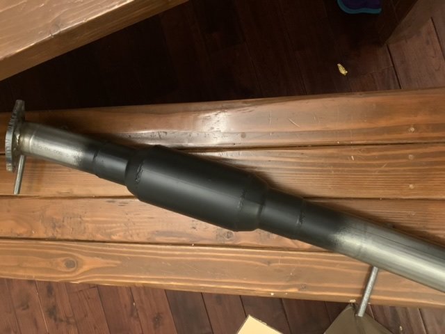

I know my muffler and the resonator are black. I cant remember if there was over spray like yours but I would say that looks about right. I believe the system has stainless pipes and non stainless mufflers. So they paint them to prevent rust. Looks like the welds were painted to keep them from corroding too.

I got all those, too. I’m sure it’s legit, it just looks different than the stock photos with that overspray.

To those that have purchased this system, did yours have this weird overspray situation on the mid muffler?
Just wanna make sure I’d didn’t end up with some knockoff garbage.
Thanks!
its probably just to protect the welds - where they weld the resonator to the aluminized pipe would be rust-prone, the spray is probably to inhibit rust

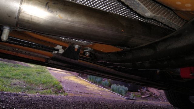

Just thought I'd update everyone on the exhaust. I'm happy with the tone and loudness but it's not the best fitting exhaust. In fact it's terrible. I've spent hours and hours adjusting it and it's either hitting the bumper, the rear axle or the cross member plate. I'm spending another day trying to get this to work. It's as if the got a couple bends in the system wrong.
Thanks!
Yes, same exact stuff on mine. After a few hundred miles it has turned into some weird powdery carbon like stuff. You'll get it all over your hands if you touch it.

The exhaust systems touching the brace is a fairly common problem with these cars. There's barely any room there's an aftermarket brace by Pierce I have one it will give you more room.
The thermal exhaust system comes with a brace.
It makes so much noise now. At least it's not ruining the paint on my bumper anymore. I'm thinking about cutting the brace to make room.

Thread Starter #36
