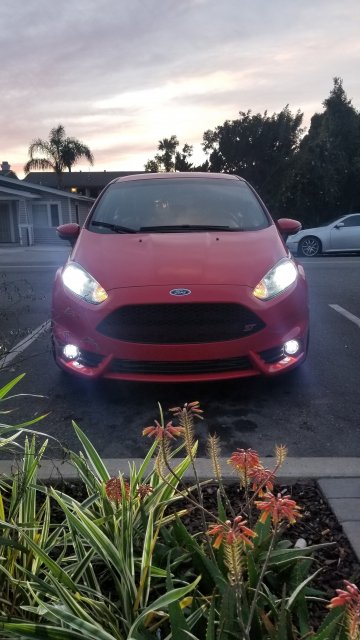

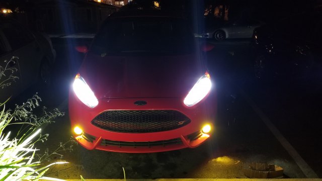

I've been using these: https://smile.amazon.com/gp/product/B07WNSKS8D/ref=ppx_yo_dt_b_search_asin_title?ie=UTF8&psc=1
They're cheap but they look great and are easy to install. The lights are generic and fit several types of cars. They're not Fiesta specific.
Mine did come with the polarity reversed, so I had to swap the wires, but after that they've been great. They change from white to yellow when you turn them off and back on.
View attachment 34446 View attachment 34447 View attachment 34448
I’ve been considering these since I’ll probably spending close to- if not more - if I buy new housings and LED bulbs.
They seem like quality pieces. How bright are the yellows?
I'm very happy with mine. Installed them sometime last year and they've been great/consistent. I do sometimes have an issue where one side lights up yellow and one side lights up white. Turning the lights on and off just reverses them which looks silly. If I turn the car off and back on, the problem is fixed. I think this has happened maybe 3 times.
These aren't bright enough to replace headlights, but on dark backroads they do provide a lot of additional light. I've never been flashed for bright lights.
