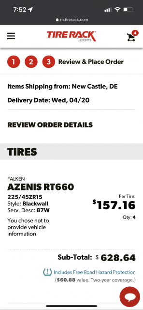

I bought a set today. I was offered a possible solution of raising the redline to 7k instead of 6500. Is that really gonna be an issue? I’m aiming to NOT bang it off the rev limiter consistently. I haven’t heard of too many Fiestas with valve float issues.
Did you go 215's? or down to 15's?

I think the increased rev limiter was discussed a while back but i dont remember the outcome of it. I shift earlier as the stock turbo, even on E30, runs out of steam above 6500.
The car has a ton of torque down low so going to a higher gear isnt always a bad thing. The car can easily pull itself out of the lower rpms as the max torque rating is achieved from right at 4000rpm(unless you have a different turbo?). Tuned i believe we make nearly 300ft/lbs at the same RPM level(4000ish?) so going to the next gear up earlier should show too much lost time on track? Autocross might be a much different situation...
The biggest gripe is the extra shift required to keep the car from banging the limiter. Its not a very good situation for this car and the tire choices we are offered.
BTW, keep us updated on how you like the RT660 in the 15" size. Interested to see how they perform and the durability on our platform.
