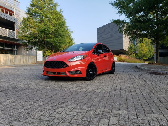

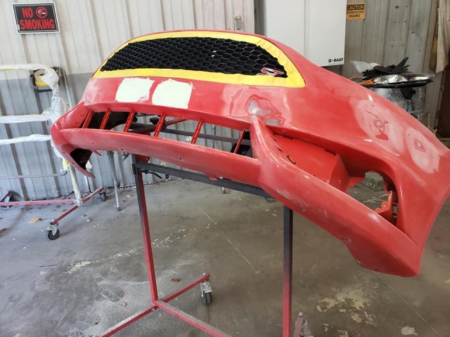

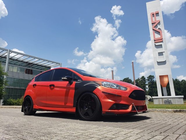

Decided to take off my Cannards, Fender and spoiler vinyl, and Front splitter. Refilled the holes made with fiberglass and bondo, then repainted. Turned out great and I love the simple, clean look. Honestly surprised the triple stage Molten Orange matched so well.

Sure! First, I sanded (with a DA) around the holes with 180 grit sandpaper (so the Bondo would have something to grip onto) and worked up to 600 grit to smooth it out. Second, I filled the holes from the back with Fiberglass. Once that dried, I filled the holes from the front with Bondo. Once the Bondo (and Fiberglass) were dry, I sanded the Bondo down until all was left was what was in the hole. Then I sanded the entire bumper with 1000 grit sandpaper and used Grey Scotch-brite to scuff it with. After that I primed over all the bondo, sanded it smooth, cleaned the bumper, and painted it.
