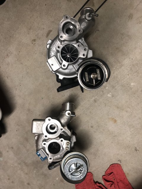

I will be installing a Tubobay Hybrid in a couple weeks and will be posting results. If anyone has there turbo in we can discuss its performance here. BE072521-13A1-4FFB-8EE4-9C0CEDC9156E.jpeg

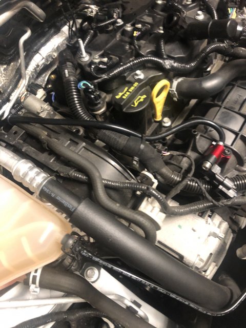

Here are a couple photos of-the install, getting the car tuned now. Will post vdyno numbers when i get it tune in.
