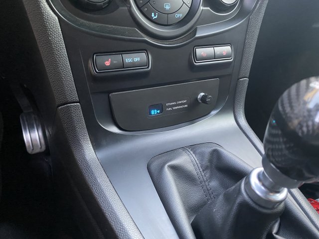

I went with the Dizzy gauge, it goes in the useless dash pocket in front of the shifter. You can put the sensor under the hood next to the pump or you can make a custom setup under the rear seat for a stealthy option. I also covered most of the Dizzy gauge with black vinyl to clean it up some more.
I like that setup. I didnt want any websites or marketing on the unit. This looks like an easy fix.
