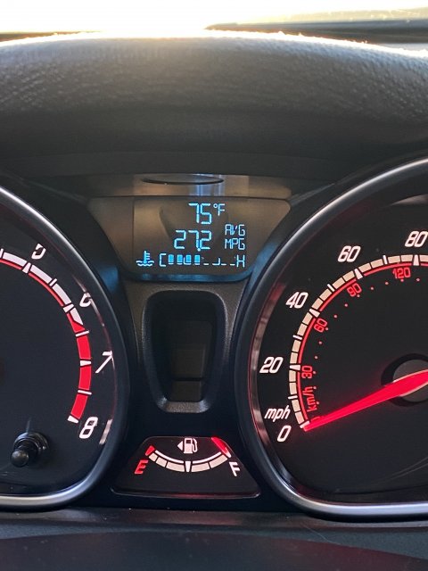

Clean the MAF, check your air filter, calculate mpg from the pump/odometer and not the onboard estimate.
Everything is clean, checked it all. I was getting 24mpg. I’ll have to calculate my mileage. I’ve gone 60 miles and my needle hasn’t moved, so idk if my mpg meter is off or needs to recalibrate itself. I reset it when I filled up last and I didn’t do that the first time I filled up.

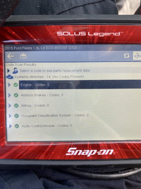

It’s throwing zero codes, warms up fine, never smells rich. Gonna go check codes again right now with my snap-on scanner.
My needle never moves for the 50 miles or so.
