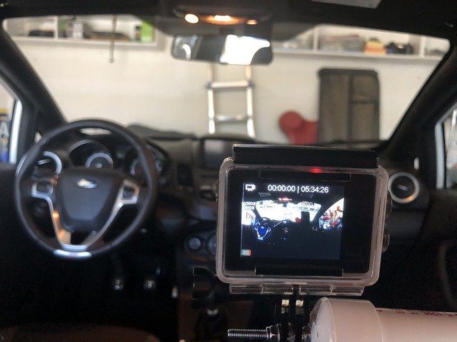

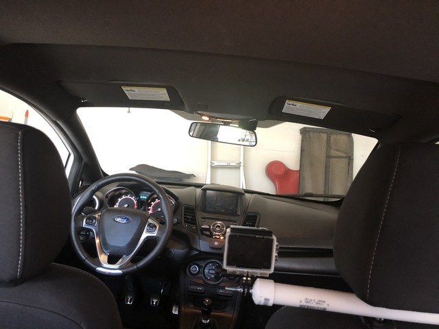

What the hell is that? It's awesome
I custom built it, out of a Pana-Vice camera mount, drilled it and added some U-bolts from a local hardware store.
Or you can use the Go Pro handle bar mount and a piece of tubing.

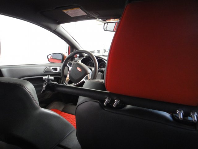

I use that headrest mount. It sits a little low so you’ll need to raise the camera some. It’s a solid mount otherwise and worth the money.
