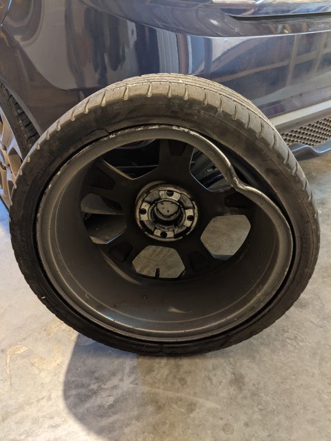

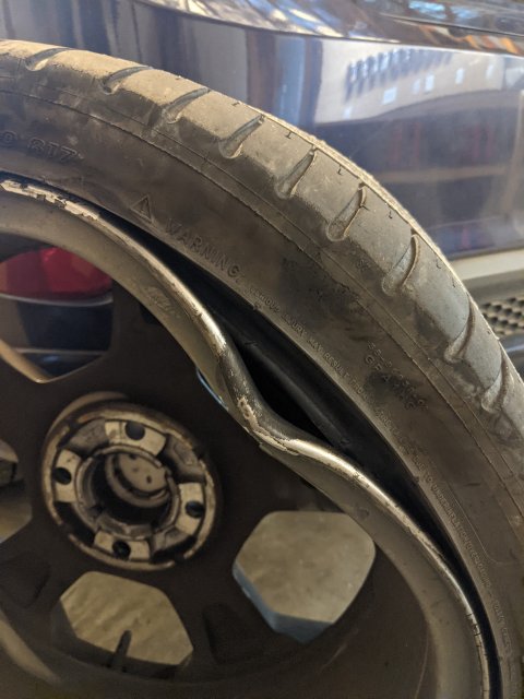

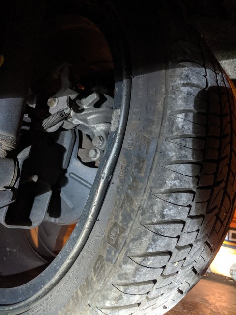

Soooo I was coming home after work and got just a little too close to the edge (on a back road) and got pulled into a ditch with pavement jutting out at the end. Basically like driving full speed into a curb. 🀦🀦🀦 Front passenger rim is the bad one in the pics, rear passenger rim got dented but didn't lose air pressure, so thankfully I was able to limp home with just the one spare.
Gonna need two replacement wheels at least... Anybody got any wheels or sets of wheels they're looking to sell? Thanks

Ouch man. At least that is all the damage you had!

I'd check your tie rod, it may be bent. Also, wheel bearing could be damaged.

Tie-rod, control arm and rack and pinion mounts should face an inspection.
I guess there's a good side to aluminum wheels after all.
They absorb much of the damage as opposed to your steering and suspension components.
On steel wheels that probably would've damaged at least one of the aforementioned parts.
https://www.wheeldoctorohio.com/
There may be a similar service for your area. Yeah it may cost just as much to fix'em but it's also keep'n a little more pocket change in the local economy.

I definitely hear you guys about the possible damage to suspension/steering components. Something I'm worried about myself. I'll be getting it up on the ramps here soon to give it a thorough inspection. At the very least, the alignment felt good driving it home after the accident, so I'm hopeful nothing is damaged. Keep your fingers crossed...

Thanks for the suggestion! I found this place:
https://carolinawheelpros.com/
Currently waiting on a quote... I'll update once they reply
