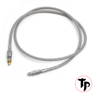

I do wish that someone developed a remote clutch speed bleeder which could be accessed from under the hood, without getting under the car, like Tick Performance did for the 4th gen f body T56 platform.
But then that car had a totally separate, dedicated reservoir for the clutch master, if that would make any difference in this being possible for us. [dunno]
