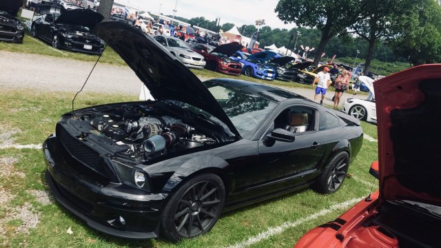

Hello guys! I’m new to the fiestas! What are some good first mods to do? Is a catch can worth it on these cars, and what’s the loudest blow off for these cars. Also can I realistically make 300 rwtq? I’ve got a supercharged mustang that’s been hand build as well! 3C63FBA6-17F3-4A21-9689-DC2DF498873B.jpeg
