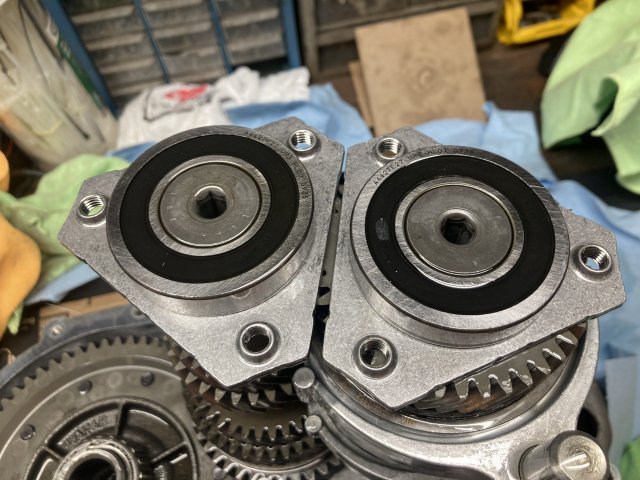

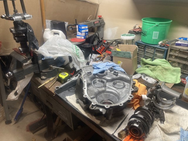

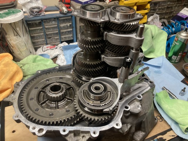

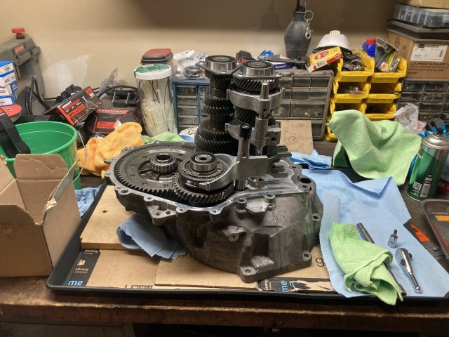

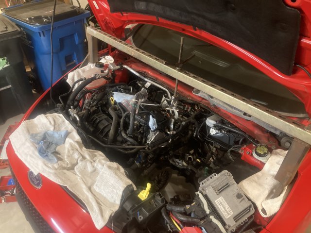

Just wanted to introduce myself as I have been lurking for a couple months. My son just purchased a 2014 ST(just got his license). As soon as we test drove it I heard the trans making a lot of noise. The dealer knocked off a considerable amount and I couldn't pass it up. Finished up replacing the bearings and throwout/slave assembly about 3 weeks ago and it's been running good. This forum has been a massive help and I really appreciate all the great information that has been posted. Hopefully I can do the same. When I saw the car I didn't think much of it but after I test drove it definitely changed my mind. Very fun to drive! Here's some pics of the trans repair. The input shaft and output shaft bearings were definitely bad along with the throwout bearing.
