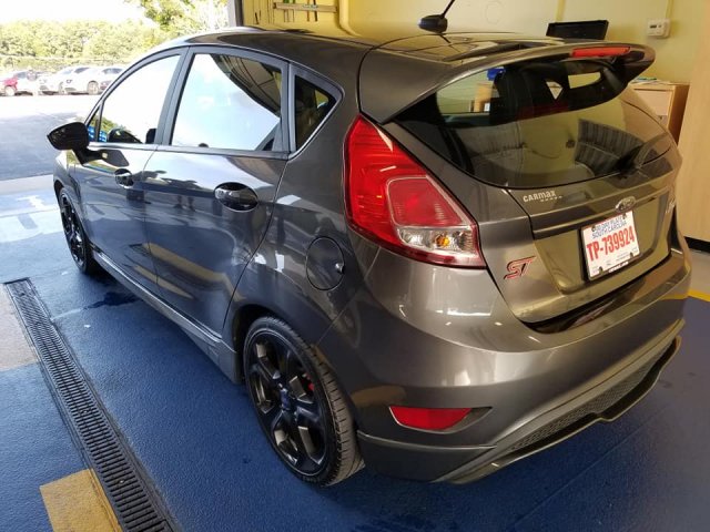

Howdy guys. I just got my first ST a week ago, and it's worth every penny for sure! The only thing I regret is waiting so long to buy one. I have plans to eventually do light mods and an Accessport, but I'm enjoying the car so much already that I'm in no hurry. I am getting the dealer sticker & front plate frame off asap, I've already ordered some matching plugs :)
The only flaw I've found is a small crack in the upper frame of the passenger vent window, the tiny triangle at the front. I've sourced a replacement already, but what I can't seem to find are instructions for actually doing it. If anyone can help, or point me in the right direction, I'd appreciate it!
