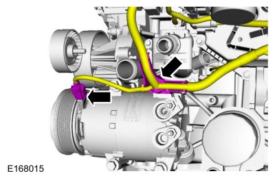

There should be a connector that powers the AC clutch, that would be enough.
I have no idea where that is, been out of the ST world too long lol. And at the moment no energy to go look it up, lol

Thread Starter #15
not sure if I can stick my hand in the gap to get there! thanks for the image, you dah man Dave (y)

This is just a sure way.
I didn't look it up but sometimes the fuses also control the high speed cooling fan and you don't need any other problems.
