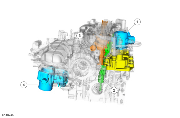

I'm sure he figured it out by now but the connector for the DTC you have is on the HPFP (high pressure fuel pump). The HPFP is located as shown below. 1597192663792.png
