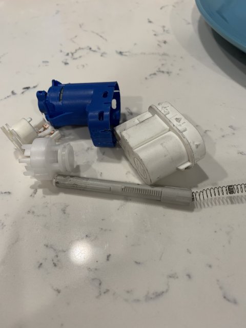

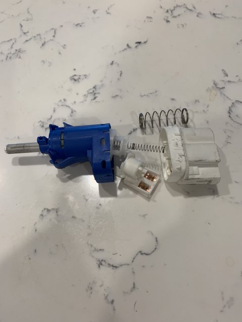

It was the brake light switch that connects to the pedal that went bad. This switch also controls the hill start assist hence the message on the driver info center. It was not the abs sensor or anything near the caliper, I misunderstood that over the phone. After he changed the part it continued to give him grief because the brake light was staying on when the pedal was up. It needed careful adjustment to get the sweet spot and not go too far and be back to square one (as he described it)
Best guess is that the teeth on the plunger inside the switch were damaged during the bleeding process.
In the end he just said what do yuh think is fair? I paid him $100 for the original job agreement, $25 for the switch, and $50 to cover the helper he hired. I might have paid more and I do feel bad he had to spend so much time on it, but at the end of the day I feel it could have been avoided if he had done some research ahead of time or been more careful during the job. Just glad it’s over. Did a brief test drive and the car seems fine.

Oh sweet. I have also replace those switches, but I didn't take them apart so it's cool to see where yours failed.
I don't think that this is entirely the mechanic's fault. I don't know if it takes too much force on the pedal to bleed the brakes or if that switch is just junk or a bit of both, but I have had to replace that switch for locked brakes AND again to fix pedal feel (detailed here) after 2-3 years of heavy track use. Using a vacuum/pressure bleeder might have avoided the issue, but those seem to be hit or miss at the shops I work with.
