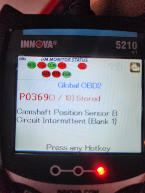

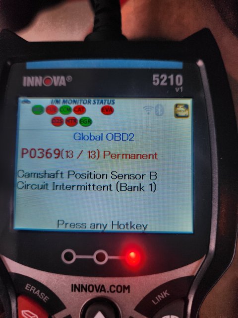

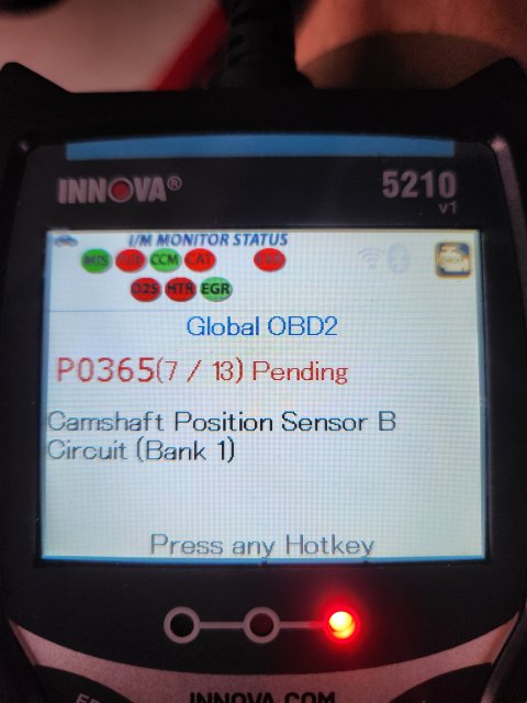

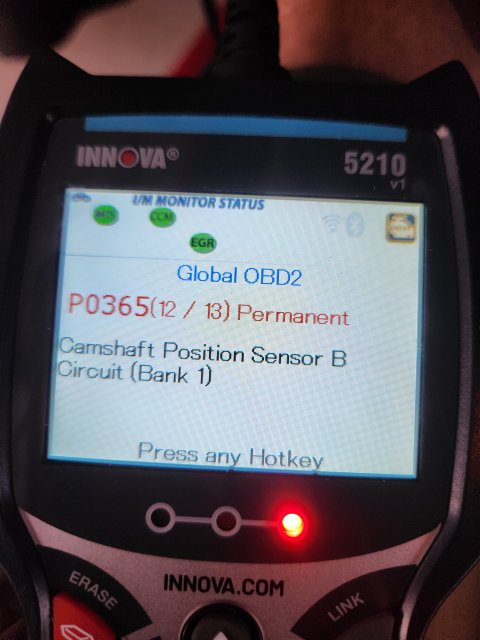

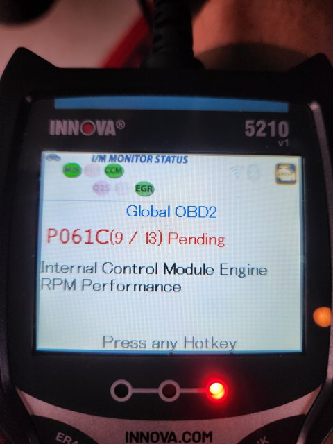

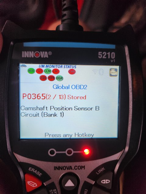

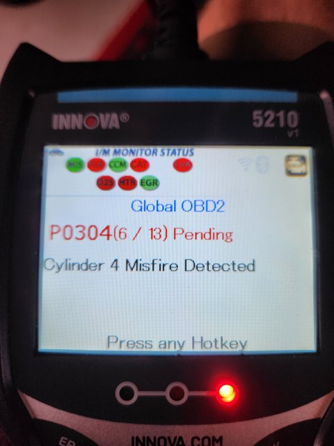

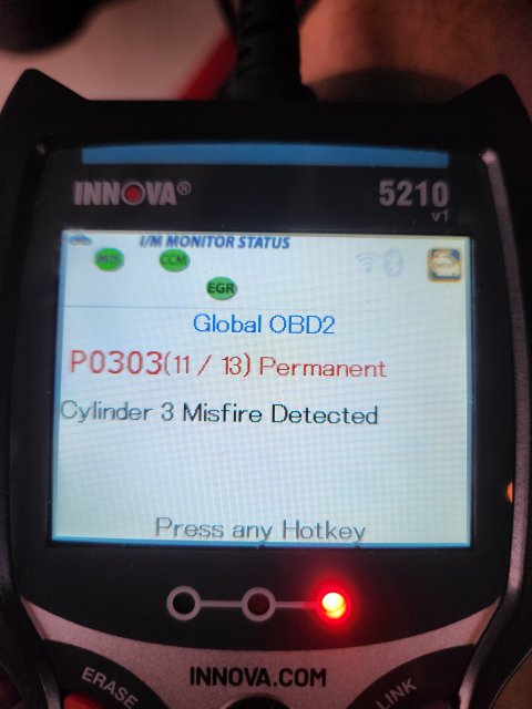

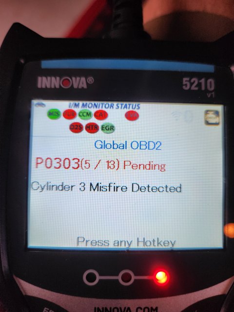

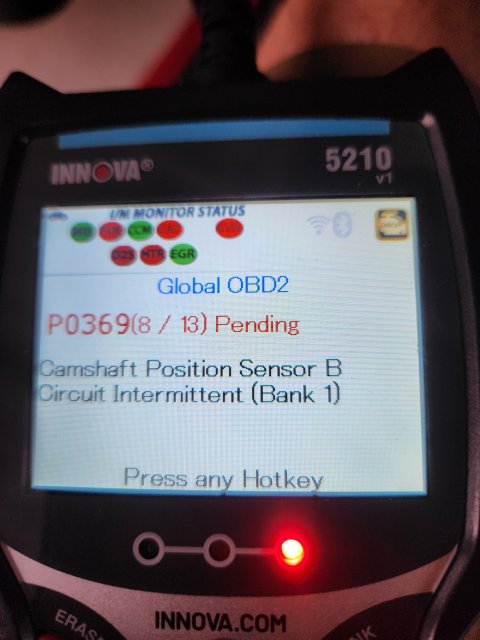

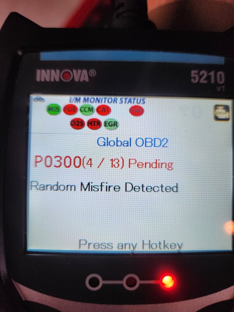

I started the car - long ignition sequence before firing up, then rough AF. I hooked up the reader and good Lord.
Any insight is greatly appreciated!
20240803_192131.jpg 20240803_192129.jpg 20240803_192127.jpg 20240803_192125.jpg 20240803_192123.jpg 20240803_192122.jpg 20240803_192120.jpg 20240803_192118.jpg 20240803_192116.jpg 20240803_192112.jpg 20240803_192115.jpg

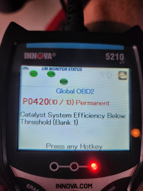

Code 0420 is from the tune, but the rest are new. 20240803_192104.jpg 20240803_192112.jpg

1st and foremost, check all plugs to make sure what ever you unplugged is full seated. Pull spark plugs and see how they look. Some crap could also get stuck to the valve seat which can cause a misfire.
4,221
2,757
A member saw a similar position sensor code with a timing belt slip. It's possible this issue were created by debris left in the intake.

I re-checked and reseated all connections, then let the car idle for a bit and it calmed down. Still have Misfire on Cylinder 3 codes, as well as Camshaft Sensor Bank B. I ordered replacement Camshaft Sensors.
After further research, I've narrowed it down to a bad injector on Cylinder 3. I ordered the part, and should have it tomorrow. Hopefully this solves the misfire issue 🀞

Hall effect sensors rarely have issues short of them or their wiring being physically damaged; more especially multiple sensor failures. Test to make sure that your wire harnesses are fully seating. I had a harness that wouldn't fully seat until I outright removed the seals. (After killing half-an-hour or more trying to figure that out, even looking at another as an example, I simply resided to compensating by cramming copious amounts of dielectric grease around the harness and around the pins. )
It is also unusual to read of a failed injector, even on direct-injection engines. When we do see posts about injectors, it's in regard to cleaning them. High pressures might result with higher failures over leakage. If the cylinder is rich, may be indicated when reading the plug.

My suspicion is the cause is a bit of walnut trapped in one of the plugs that was disconnected to gain access to the front of the engine. Solution is to trace back from the camshaft sensors to identify that particular plug and use a small flashlight to inspect it carefully.
