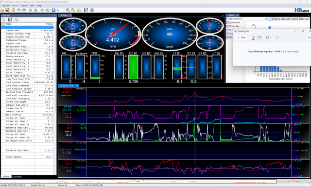

I tried logging some stuff but im not shure if i got the important stuff... Cant share the log so i share a print screen. Is this telling U anything?
Tell me what i shuld log and ill share it here? Apresiate the help of u guys!
Grombil
#26007
12
3
Thread Starter #18
Im sorry i realise i have 2 profiles... Ill stick to this
