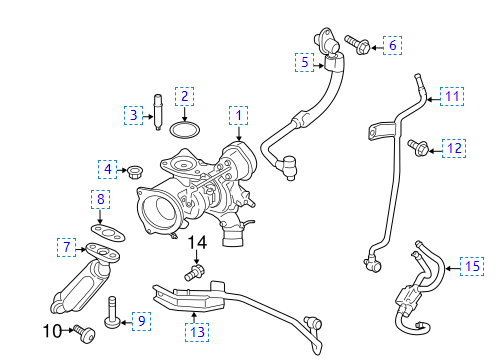

Awesome, thanks 😊 you don't happen to have any idea about any extras needed? Like if the factory oil lines/fitting are all able to be reused as is? Thanks 😊
I See nothing about a gasket kit being included from Pumaspeed* So i would be contacting them about that. Every Turbo i have installed came with all the necessary gaskets Etc. All my Turbos have been Garrett though. You will also need to do an Oil change too as the New Turbo needs to be primed with clean oil before startup to ensure longevity.

You need a new Turbo drain gasket OEN 1331076(nr. 8)
And I'd recommend new crush washers for the banjo's on lines nr. 5, 11 and 13 where they connect to the turbo. I can't remember the sizes. It can be done without, but since it's crush washers better be safe than leaking ;)
