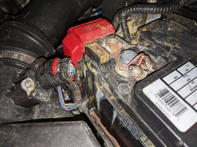

My third major issue involved the battery clamps. I went to start the car and it tried and failed and then the electrics all went out. I waited, the electrics came back and I tried again, same thing. I remembered seeing some corrosion around one of the battery terminals that was there when I bought it and this turned out to be my problem. The ring going around my positive battery terminal was pretty severely corroded and I had to take it all apart, clean it all and then I actually had to use some copper wire to clamp the ring tight around the battery terminal because it was so corroded the bolt had nothing to grab anymore. PXL_20210218_040436480.jpg Eventually I will purchase a new ring to fit around that battery terminal.

Welcome. Did you inspect this car before purchase. That battery looks terrible. How many miles are on the car? All of this sounds like bad maintenance on the part of the previous owner. Good luck and hope you. don’t have a lot of other problems..

That battery terminal pic above is enough motivation for me to keep on buying AGM batteries from now on, even considering how much costlier they are over most flooded lead acid deals. [wink]
Nah I didn't get it inspected like I should have. 🀷
It's at ~52k miles currently. I too suspect some poor maintenance
Yeah I'll def be going that route after dealing with this. I always ran deep cycle batteries on my subie and had no issues whatsoever
Yip, N-E-V-E-R going back to the open vent design. OMG what a difference. Having a high refresh-rate volt meter plugged into the vehicle outlet, I can see the charging system has gotten sophisticated. It's not the on/off switch that it used to be in the old days. Maybe it was charging the Pb/Acid battery differently than the AGM, but I have no idea why that Motorcraft battery puked so much. Maybe all the tossing around we do in these has something to do with it?

@haansoolo - Note, have plenty of time on hand after pulling up that battery tray. Ford seems to have a nasty habit of placing an unprotected ground wire connection beneath battery trays. If it is trashed, add a new one to augment the existing, rather than attempt R&R existing.
There is a computer attached to that battery tray. I just removed the entire tray with it attached. NOT damaging the connectors on the ECU is important and there are videos that cover that. Here's one example...
View: https://youtu.be/xnaZJClZedk?t=420
...and removing the crap he does is unnecessary. Just remove the obvious stuff.
