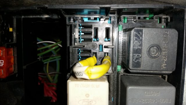

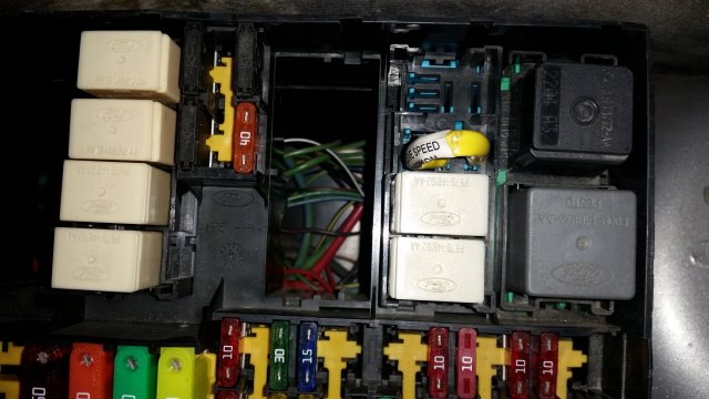

Its been a long time since ive done wiring like that. Im up for it. ( i wonder if i can make the empty socket useable so the relay just plugs in like normal. Not like i couldnt find a spot out of the fuse box for a relay to sit. Would just have to label it. I can run the wiring out of the symposer hole 🤔
Ill have to look and see if there are pics to follow for sure.

The wiring mod for fog lamps using a relay to allow bambi mode. I can wire it up if i have some visual instructions.

#30
Independently Operated Fogs
This is a relatively easy MOD.
The Fog Light Relay is negative triggered.
So a switch to ground (-vdc) is all that you need.
Under normal operation, the fog light switch tells the BCM to turn on the fog lights.
This is done by sending a ground signal to the fog light relay (R11) terminal #2.
So this method turns on the fog light relay (R11) in exactly the same manor.
Just connect a switch from terminal #2 of R11 and the other side of the switch to ground.
I set up my FOGs as DRLs so an extra relay is was required.
D1JL
7000 Post Club
Staff Member
U.S. Navy Veteran
7,928
4,190
SFV, So.Cal.
#31
How to wire the FOG lights as DRLs.
It is actually very easy.
Just buy a Ford relay just like the current fog light relay and a fuse power tap.
You can use terminal connectors but it fits better if you just solder wires to the inside of the relay.
This way everything fits in the relay/fuse block next to the battery.
Remove the relay's plastic cover, it just pops off.
Connect wires to terminals #1, #2, #3, & #5.
If you connect to the inside of this relay you can drill a hole in the plastic top and run the wires out the top.
This will allow you to place the relay into an unused socket with no connections. (Space for R12)
The relay will just sit there and the box cover will keep it from jumping out.
On the new relay, connect terminal #1 to the hot side of fuse # F20 with fuse tap.
On the new relay, connect terminal #2 to ground.
On the new relay, connect terminal #3 to terminal #2 of the car's fog light relay (R11).
On the new relay, connect terminal #5 to ground.
