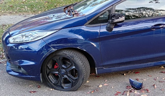

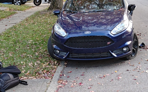

2016 with ~76,000 miles. Parked at home wheels straight, came back from work on my motorcycle to find my car knocked up into the grass, wheels cocked all the way over. This was a hit and run. ** (suspected perpetrator of this incident at end)
As you can see in the photo, broke the mirror cover, knocked the (folded in) mirror mount loose at door, dented and scraped the fender above wheel well, touched the bumper, blew the tire after rolling up onto the backside of it, little paint missing from the face of the wheel. After driving up on ramps to swap the wheel on the street, I could tell it was driving on the tire sidewall. Noise from the steering column and can feel some binding when turning.

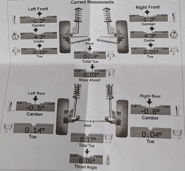

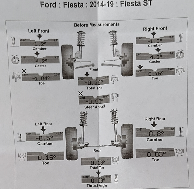

$1,200 for a new struts, driver side inner and outer tie rod ends. I did not receive a pre-strut replacement alignment, but below is the post-strut replacement alignment sheet.

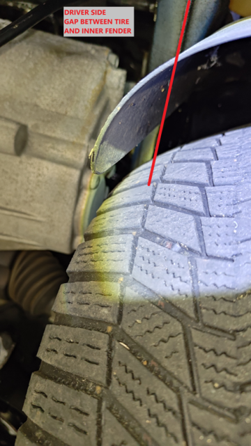

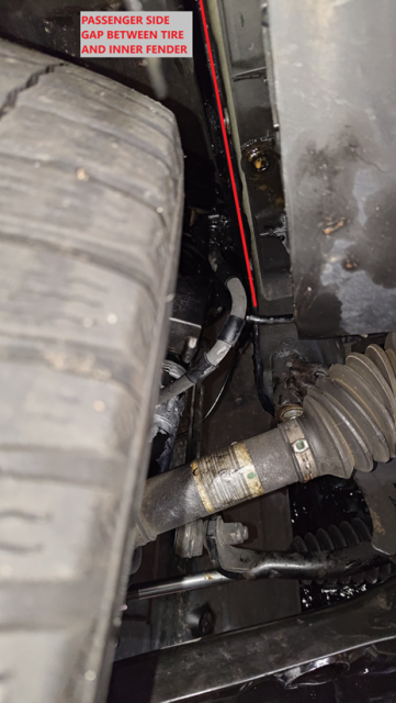

No longer feels like it's driving on the sidewall but is clearly not right. The driver side tire inner sidewall rubs when turned to lock. The passenger side I can stick my hand in there with plenty of room.
I told the shop this and was basically blown off, saying the suspension needs time to settle. Repeating the story of how it was knocked off the road into the grass, was again blown off. Was told to bring it back after having the body shop do their repairs.

Regarding the rub on driver but not passenger, the driver strut appears to be much closer to the inner fender wall, than the strut on the passenger side. I have no understanding on what may be causing this.

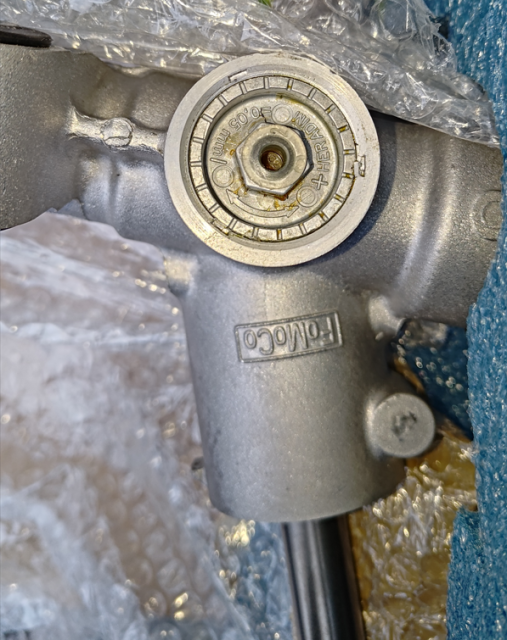

The rack & pinion does have a slack adjustment. Since you have to drop the sub-frame to get to the slack adjustment, I replaced the entire rack anyway.

Those who claim to have issues with "drift compensation" may wish to tighten things up using the slack adjustment setting on the rack.

  • Driver side tire makes strong contact with inner fender on right turn

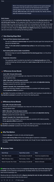

When asked about the mechanical steering stop, AI seems to imply that this can be handled by contact between the tie-rod end and steering knuckle. Skeptical but will confirm. Would be nice if all I had to do was replace the driver side steering knuckle. But it is a common intersection between suspension and steering.
I did run across a 2020 year pre-wreck alignment sheet. (Dealer under warranty unnecessarily replaced axles and did not perform an alignment following the work; which was obvious in driving.)

your left/right steering issues, as well as the tire rubbing, i believe will be addressed with an alignment. when swapping out the steering rack, you have to thread the tie rod ends in and it's difficult to get them both the same, so i think you'll be good once you can get it on a rack and get it sorted. Make sure you tell the tech who's doing the alignment about what you're experiencing or they may just check toe/caster/camber and send it.

Appreciate your looking things over and commenting. This is not just a rub, it is literally striking the inner fender.

I am wondering, has the car been measured and found to be straight and square? Are the mounting points for the suspension in the correct position at every corner? Is the inner fender in the correct position?
If the car is straight and square, the suspension and steering mounting points are all in the correct places, and the tie rods are threaded in equally on both sides, one would think that when aligned correctly it should be all normal.
One might think that if the car was hit on the drivers side front wheel, and then rubs the inner fender on that side, that the car is bent such that the control arm on that side is too close to the inner fender.

Looking at the 2020 alignment sheet versus 2024, the rear alignment has me worried about the "squareness" but that could've been a result of a tech sitting in the vehicle or the door being left open.
IIRC the alignment is supposed be performed with me in the vehicle but I don't ever remember a shop doing that. I'm not a big guy and don't ask to be in it.
