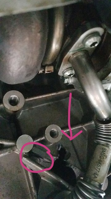

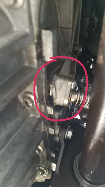

Just lifted her up today. The oil return line, above the oil pan, that mates to the engine block has blown off the block and took a jagged chunk of aluminum block with it.
So my question is what could've caused this? There is no way that crank case pressure was strong enough for that. What was the vibration/noise leading up to the bang? No check engine lights came on to warn me or indicate the bang was on it's way. I'd love to just think that this wasn't my fault and that i got a bad block from Ford.... but that seems pretty unrealistic. I don't know how yet, but it is FAR more likely to be an issue i created while modding :(
Thankfully i have an Uncle that can come fabricate a block off plate and weld it to the block. But that's only part 1 of this problem.

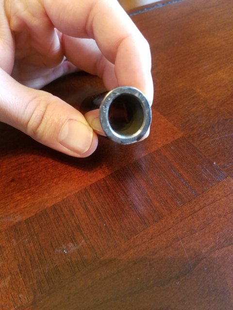

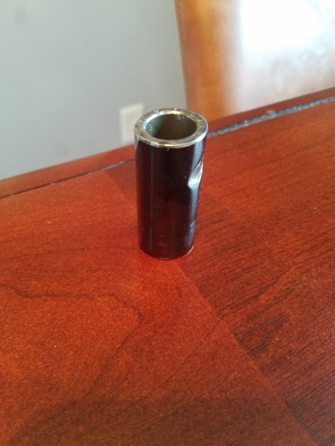

Well i was fingering the hole in my block and felt a loose part inside. So got out the trusty magnet wand and fished it out. Ever wonder what your piston head pin looks like? (I think that's what this is...correct me if im wrong) So it was internals related. I don't understand how that could pop out and throw a rod and yet there was no metal in my drained oil. I probably won't have any more updates for it until i can pull the engine :( I'm going to try not to let this get me depressed, but this is my daily driver with less than 12k miles, and not even fully paid off. Having a bad day.
Yeah this makes more sense now.. Sorry to hear that. Is your oil feed to the turbo still installed? This is a weird failure given your modifications. Did you do any datalogs after installing the tune?
