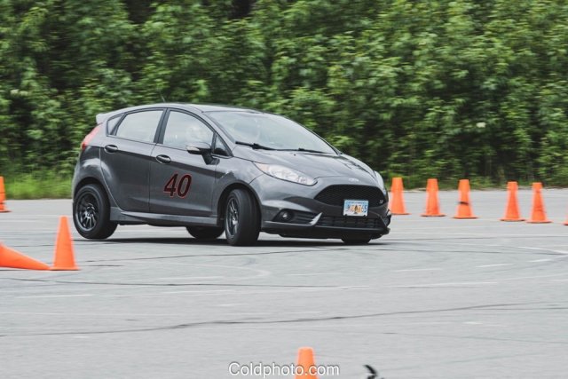

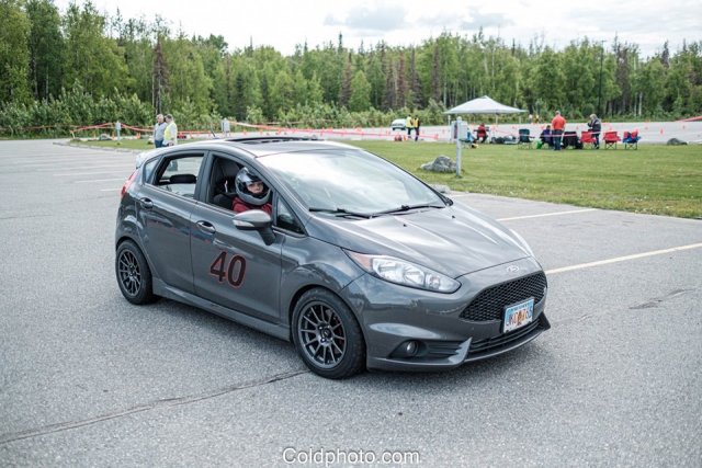

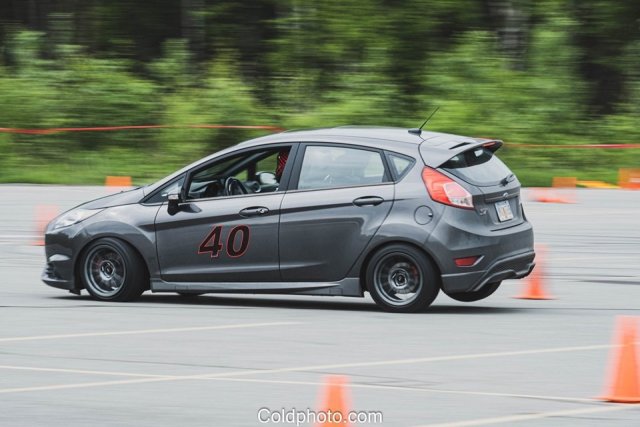

Sure thing!
I think this is about as much tire as you can squeeze under there without rubbing- I took off the rear brace because it didn't play nice with stiffer rear springs, so the body roll is a little reduced from what you see here.
Damn, now I want to go autocross.
