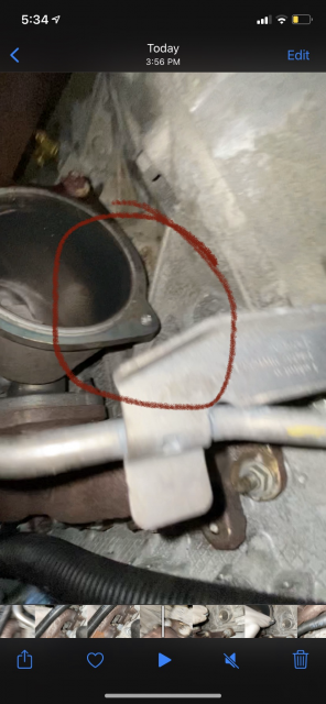

I snapped the top bolt connecting the downpipe to the turbo exhaust manifold - can I just put the other two back and drive?

I was installing the whoosh catted downpipe and when detaching the stock one from the turbo I snapped the top bolt. It’s not accessible with pliers to torch it and wiggle out or drill. Someone told me I could just attach the remaining two bolts, use high temp gasket sealer, and a C clamp where the last bolt is and send it. Since this is way cheaper than a shop I’m wondering is this a safe and viable long term option?

Anything using a C Clamp is not a permanent fix when it is related to a vehicle. The best way to fix it is to remove the turbo and drill out the broken bolt then replace it. Because of its design I'd say that is actually the one that you need most compared to the other two.

lol c clamp. You are telling me you can get a c clamp up there and tightened but not a drill/tap? I'd take the turbo/manifold off and do it the right way. It will inevitably be good practice for when you replace the turbo some day. No offense but the lengths that people go to cheap out on doing things the proper way is impressive.

Do you know of any online tutorials for getting the turbo out?
That’s what I figured. I was hoping for it to be trye lol. Do you know of any tutorials for getting the turbo out?

This is my first car that I’m working on. The friend in question is a mechanic for planes and has built a couple cars but they all have been pretty… ghetto for lack of a better word.
I looked up videos of the stock turbo removal and it looks pretty easy but I’m concerned about another snapped bolt in the manifold.
The studs in the head tend not to break, I have only had one ever do so, and it wasn't from removing or installing.

First off, find a local retailer who stocks Kroil. Because you need to start this process by soaking all of the manifold bolts with Kroil for 2 or 3 days and keep adding some during that 2-3 day soak. BTW, WD-40 is NOT KROIL AND DO NOT EVEN THINK ABOUT USING WD-40. WD-40 is a rust preventative and not really a true lubricant. If you want snapped bolts in your cylinder head WD-40 is a good way to do that. Note, by going to the Kroil Web Site you should be able to find a local retailer who carries it.
Second, there is a technique to getting rusted in fasteners free without snapping them and Kroil is just phase One. Phase two is very time consuming but it's the best way to keep from snapping more bolts. That is to work each bolt out one at a time and you MUST use a back and forth motion. Basically once it breaks loose you only back it out a 1/4 turn, and then you run it back in 1/8 turn. What you are doing with this back and forth method is grinding any corrosion into a very find powder. BTW, adding Kroil during this process is a GOOD thing to do. Do not be surprised if it takes 15 to 30 minutes per bolt. I had one bolt on a motorcycle I restored that took me 2 full hours to work free. Yes, you can take some shortcuts and go a full turn or two once the bolt is 1/2 half way out of more but if you feel the bolt starting to bind then stop right there and intensify the back and forth for at least 2-3 turns out. It is a bit of a feel thing, you back the screw out till it binds and then reverse and grind some power. Note, do not try and run the bolt back in for full depth, you will simply jam it into all that powder you've created. Time for getting the powder out is after you have everything apart and you will want an air gun for that.
I will also suggest CAREFULLY chasing the threads with a tap after blowing out the dust. Note, start the tap into the existing threads by at least 2 to 3 full turns by turning the tap with your naked fingers. Because it is very easy to cross thread a tap into existing threads if you try and just run it in with a tap wrench. Using your fingers means that you'll have to wiggle the tap into full engagement with the existing threads.
