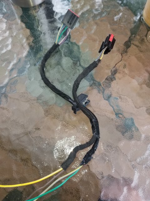

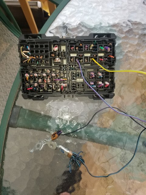

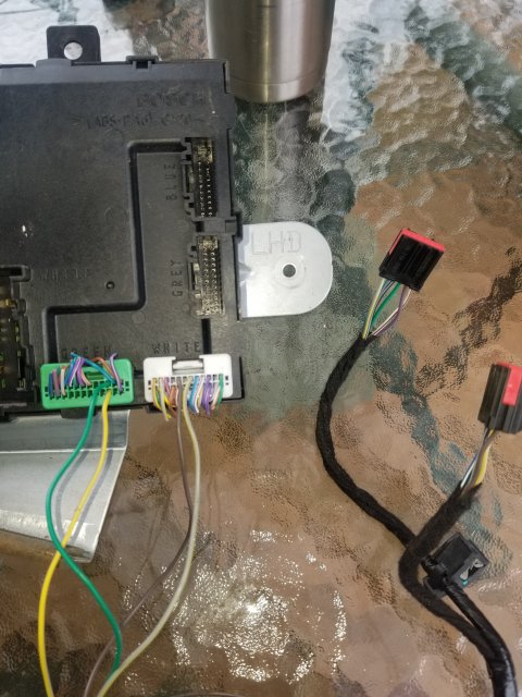

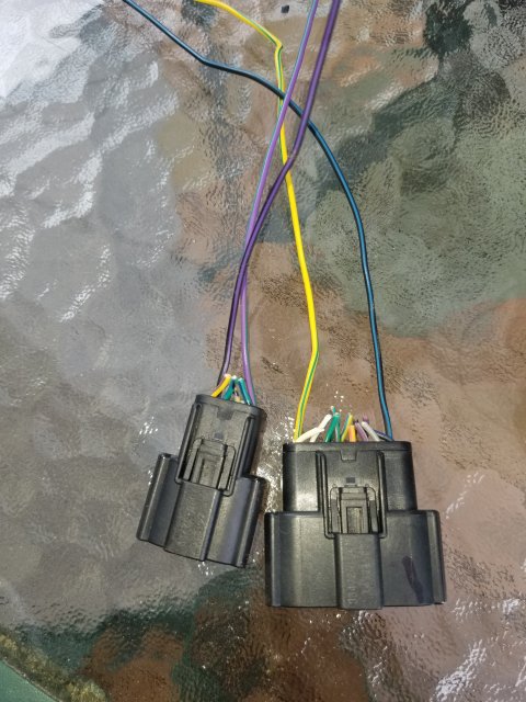

Are you guys working on this still? I bought a complete totalled fiesta st for parts with recaros. Mirrors bolted on and worked plug and play. I have now figured out the missing wires between my base seat car and the parts recaro car. I split all the factory dash wiring from the switches to the bcm. And split the wiring from body harness from the seats to the fuse box. Getting close myself. Wants to see if some one knows more then me and can give me some pointers I may miss before attempting this swap.
