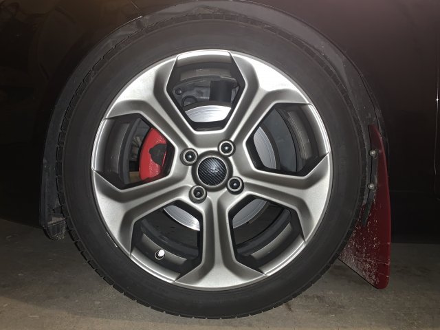

I run that size no issues and am lowered aprox an inch or so... my front fender liner is eaten. But that didn’t occur until I removed the lower plastic skid plate thingy for intercooler. Haters gon’ hate! But, I also have to mention... my tires are trash and they came with the car....
