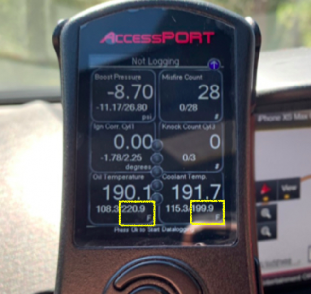

Thermostats are part of the equation. Here is some real world data presented specifically from my FiST.
Max temperatures for oil and coolant have been highlighted. Data was collected after high load, high rev, ~40 minute canyon runs.
Huge drops IMO, and I'm glad to have done the mods.
Stock OE cooling system with stock oil cooler.
After Mishimoto Radiator and Motorcraft 180 Deg F thermostat with stock oil cooler.
Note: higher boost with this run.

This is the kind of data that needs to be posted.

What do you think your results would have been if you had just done the thermostat and not the radiator? I'm going to say with a radiator upgrade with your original thermostat would have been 215 max temperature.
koozy
3,219
1,912
Los Angeles, CA, USA
It would only be a guess because I didnโ€™t get to try that and I hate to be a guy that gives out false claims and facts.
My best guess is max peak temps would be little to no change from OE, however with a lower temp stat it would take more time to reach that max peak so thatโ€™s where some benefits can be experienced with cooler running temps across the board with oil and coolant because more cooling is being provided and sooner. Thatโ€™s why people who do the swap note the cooler operating temps.
Upgraded radiator has the biggest impact.
