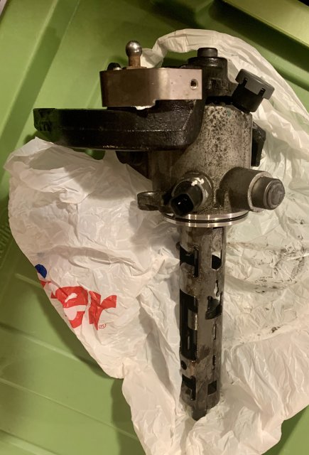

I just bought this because i wanted to greatly reduce my throws. Maybe one day will get the coolerworx lever but it seems they dont pair well. So before i pull the factory ball out, has anyone ever successfully pressed the factory ball back in?

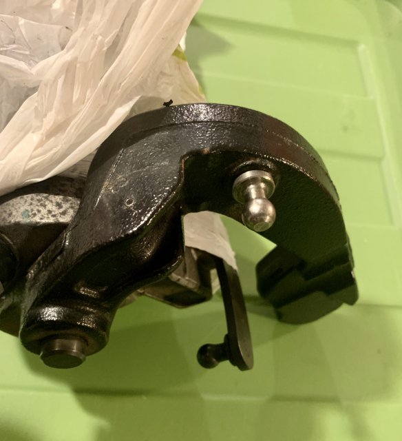

I did when i put the coolerworx in. You need to remove the whole unit from the top of the transmission. Make sure car is in neutral and wiggle it out. Then you can remove the mountune adapter. I used a deadblow hammer with the mountune pin puller as a holder for the stock pin.

Looks pretty involved but not terrible. Thanks.

It wasn’t too bad. I couldn’t get the assembly out at first, was a little timid and i didn’t want to break anything. I just wasn’t pulling hard enough. I did not try both the mountune and the coolerworx together. The coolerworx is perfect as is, I don’t think it needs to be any shorter.
