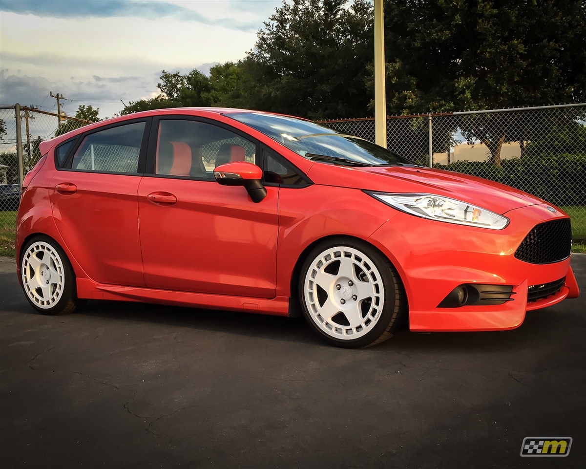

I found these on the site and could not find them. I will probably change my wheels/tires beginning of next yr. Or does anyone have solid recommendations in the 16 or 17 range. I also looked at the mr125's and O.Z. FORMULA4 HLT

For wheels, the fiftee52 Tarmac is a pretty popular option
or the Turbomac too
