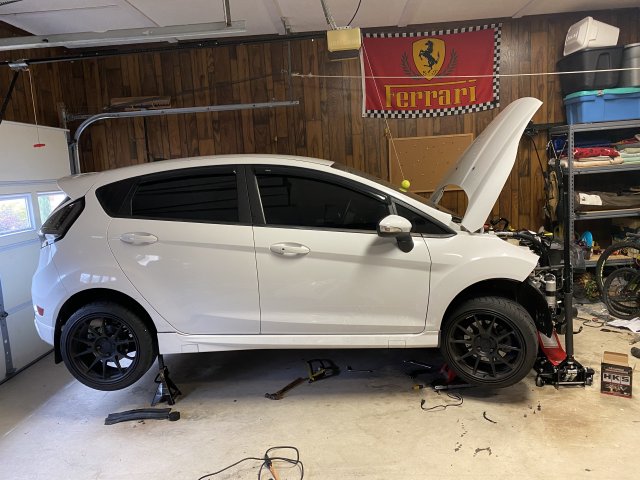

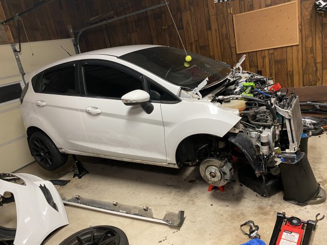

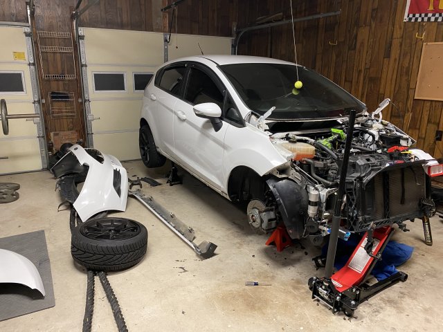

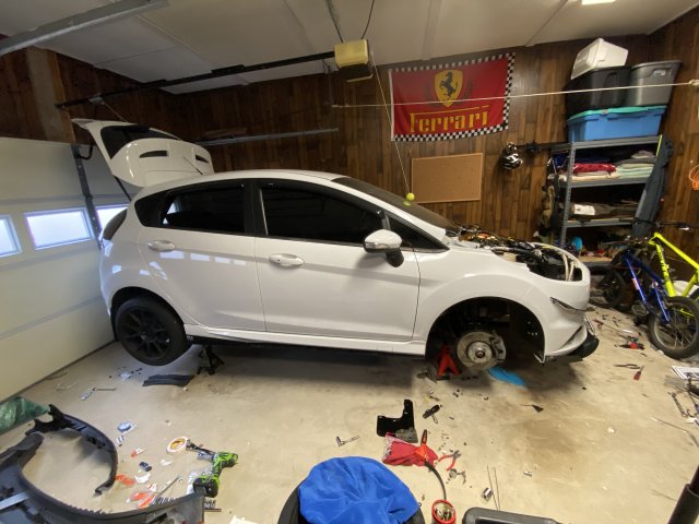

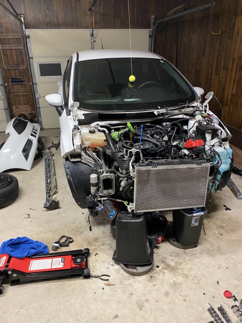

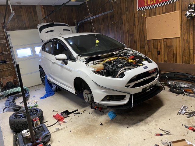

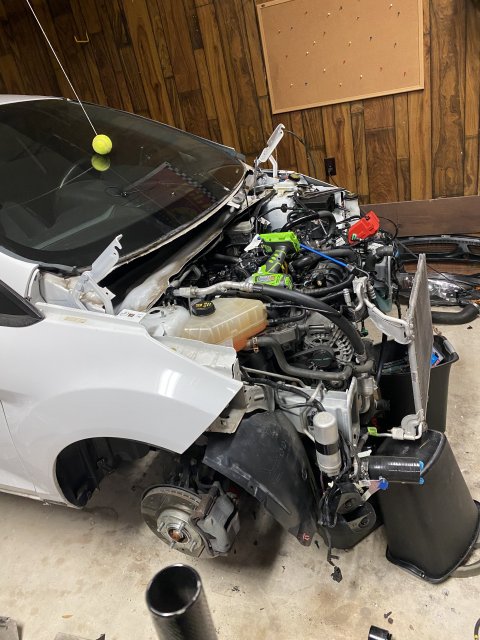

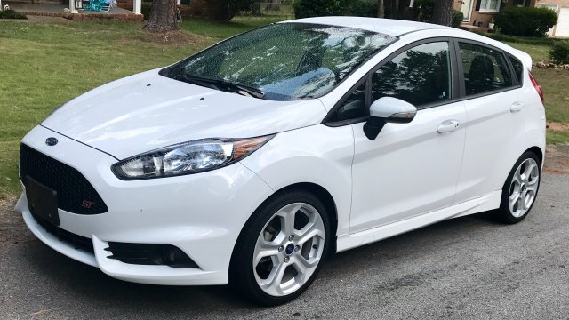

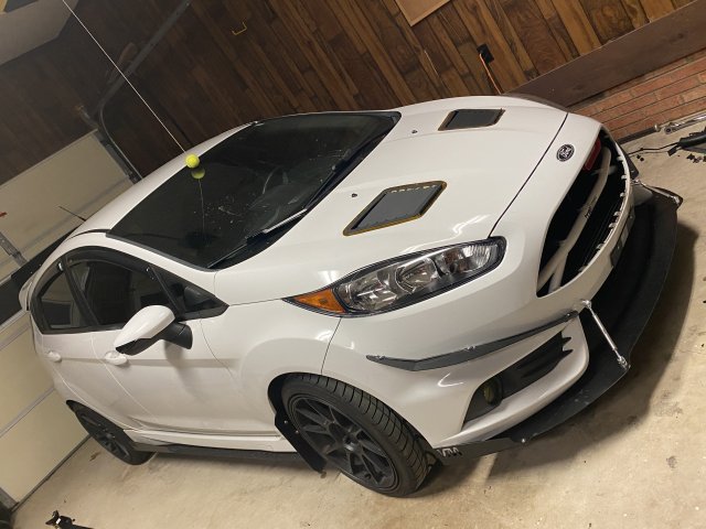

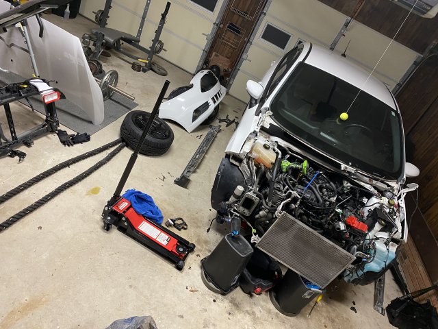

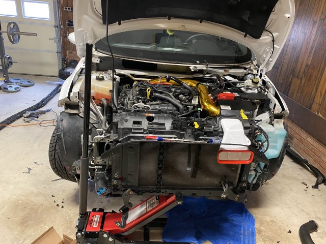

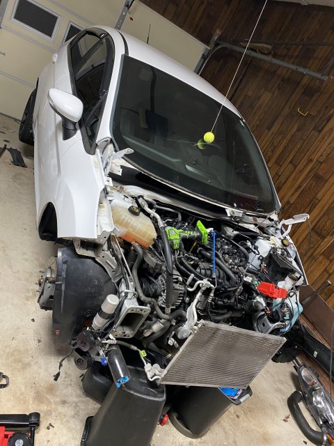

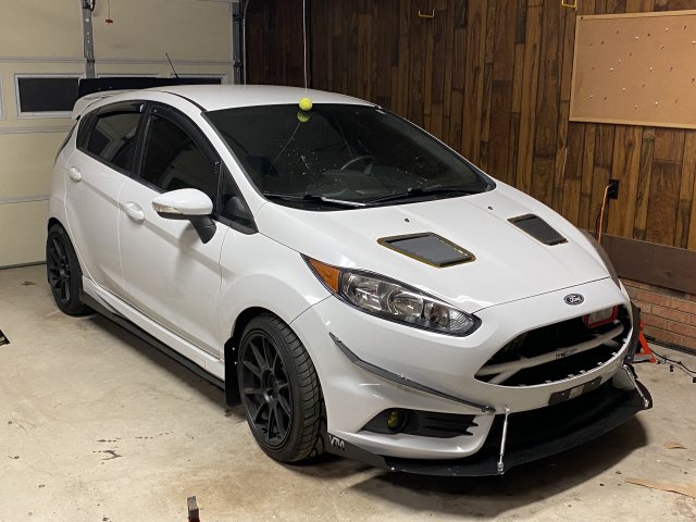

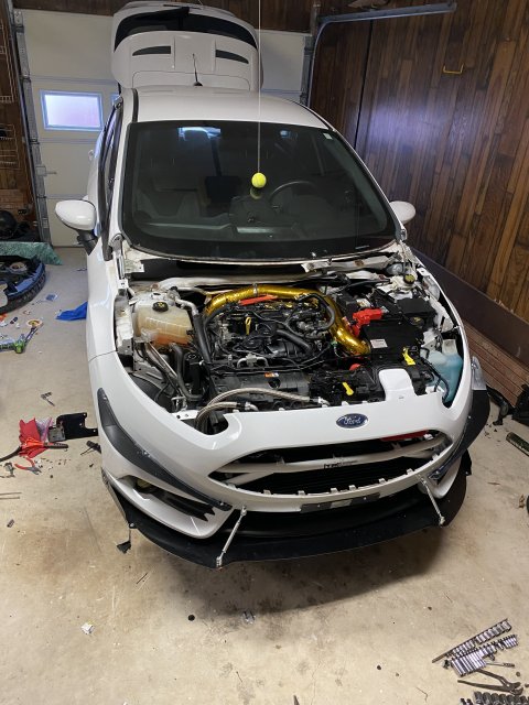

Hey everyone, I’m kinda new here and wanted to say hey. I’ve been lurking in the background for a little while and almost never post on forums or FB but here I go… I have a 2015 FiST that I got last September and I’ve already got it to FBO and of course, I’m wanting more. I hate to admit it but before this car, I had never even changed my own oil. Over about 4-5 weeks in my spare time, and learning as I went, I surprisingly managed to do all the work myself. Aside from a cracked windshield and some minor fitment issues with the bumper cover/oil cooler lines, everything turned out pretty good. I need to re-do a few minor things but all in all, I consider it a success.
My current setup is:
20% Tint
Eibach Front/Rear Swaybars (Only the rear is installed atm)
Rota Titan 17x8 w/
NGK Iridium IX-6510 1 Step Colder
Pierce Front Strut Tower Bar
Pierce Midship Brace
Mishimoto Radiator and Hoses
Cobb RMM
Cobb Exhaust Hangers
Injen 3” Cat-Back
Wagner FMIC
Mishimoto CAI
Cobb AP v3
Spec-D Tails
Clear Third Brake Light
Whoosh Ceramic Coated Catted Downpipe
Mountune Quick Shift
CP-E Exhale Cold Side Pipes w/ HKS Sequential BOV
Mishimoto Hot Side Pipes

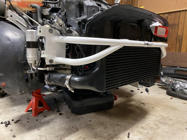

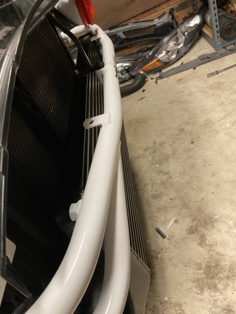

TB Performance Crash Bar
Vega Front and Side Splitters
Vega Canards
Vega Wing Extension
Fully Torqued Racing Support Rods
Black w/White Ford Emblems
Sequential Turn Signals
Velossa Tech Wing Risers
Whoosh Transmission Cable Bracket Bushings
Boomba Shifter Base Bushings
Mishimoto Oil Catch Can
Mishimoto Thermostatic Oil Cooler
Verus Hood Louvers
Verus Rear Diffuser
Mishimoto Magnetic Oil Drain Plug
Rally Armor Black w/Red
Reflect-A-Gold Heat Tape on Intake & Hood (Mainly to cover the hack job I did)

Did you have to do anything different to get those tires and rims to fit to fit under the car? Spacer?
I had spacers on at first but they rubbed BAD... no spacers now it only rubs on drivers side if I cut it all the way to the left
