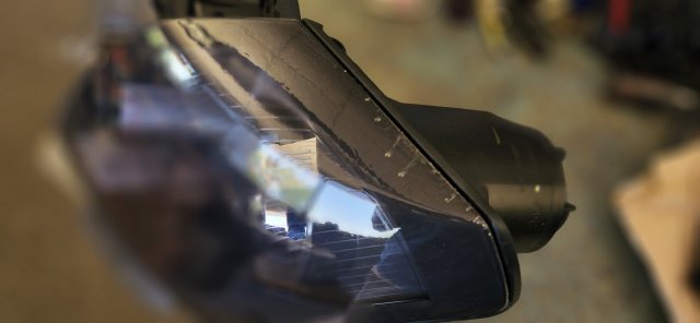

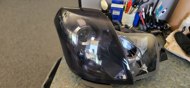

6,188
5,828
#19
Agreed the fog lights weren’t bad at all to do but the headlights are hell. My euros got dropped off today to have done in some 55% PPF by a pro cuz I’m not messing with them after the first failed attempt lol
This is what I am planning on doing with my Euro’s ( which are actually the Ford ones so the aim is correct i.e. LHD Factory Ford ) hence why I have not put them on yet. Ya I got them a few years back for a deal.
