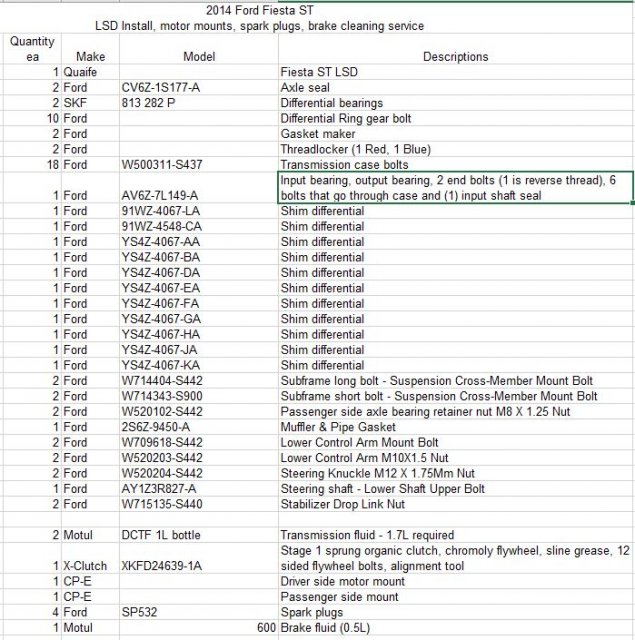

I just finished this project, picked up my car from my local Ford dealer last Friday, see this entire list of things you need. You will need to buy all the different shim sizes but will likely only need 1 or 2 of them but is better to have all just in case. I bought all my parts excluding differential shims from Tasca Ford. Would recommend buying new drain plugs for the transmission as the stock ones didn't seem to want to seal properly, just got that fixed today with some aftermarket drain plugs with washer. I bought the input/output bearing kit which was $67usd and comes with new bolts (6) for input/output shafts. I never rebuilt the entire transmission but only replaced the input/output shaft bearings as its pretty easy to do that part and generally the input/output shaft bearings are the typical items in the FiST transmission to fail. I bought the differential kit from mountune for $215usd. All of the items on the list as per the Ford service manual is what they recommend to replace and not re-use, the diagrams show pitching most of the bolts in the garbage due to being a torque yield style of bolt.

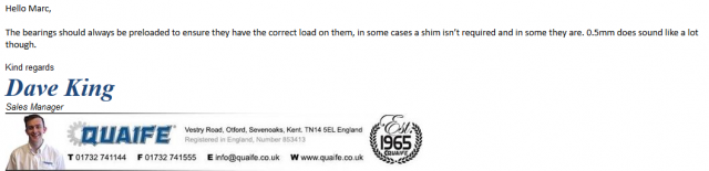

I sent an email to Quaife and this was there response below:

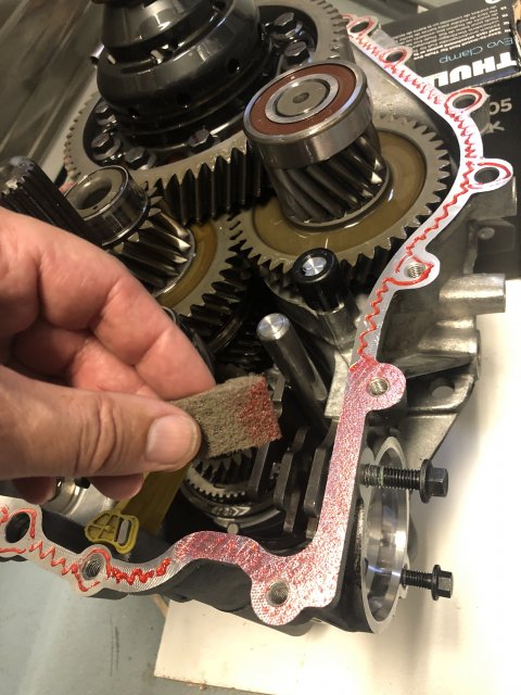

I have the Ford hardware/sealant kit... and as I assemble the cases... the sealant provided looks more like red loctite... double checked both the package and the tube... am I crazy?
Is this part of the differential kit from mountune? If so it isn’t locktight
203
54
Prince George, BC, Canada
This is what my install looked like, was done at my local Ford dealer by a friend of mine.
420
325
Phoenix, AZ, USA
#19
Looks like the same raspberry jam in a tube... although I didn’t spread it on as thick. I guess it’s similar to the blue Hylomar they make, it never really dries but leaves a thin layer of goo that the oil doesn’t wash off. I use a small piece of fine scotchbrite to even it out a bit. Thanks for the vote of confidence. BTW the Ford Performance Kit (not Montune but they sell the same) shows flipping the tranny the other way when assembling, and I would say I prefer the Ford Performance instructions if anyone is contemplating this job, it’s a lot easier to stack everything up the way they show it, your friend followed the instructions in the service manual. Thanks again.

#20
I would leave the "Bead" Like the one above .
