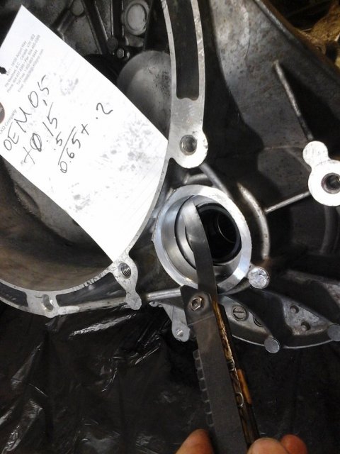

installation was easy aside adjusting bearings pre-load.
that was a beatch! u got to put the whole thing together, measure play and order shims
from a dealer, wait a few days and hope you'll get it right from the first try.
and yeah parts guy won't have any idea what it is and why you want them to begin with.

If You haven't removed Your stock one yet and haven't tried to install LSD You will never know.
And i can assure You it WILL need shims for preload adjustment
unless the width between bearing races is exactly the same as the stock one installed in Your car
which is never the case.
