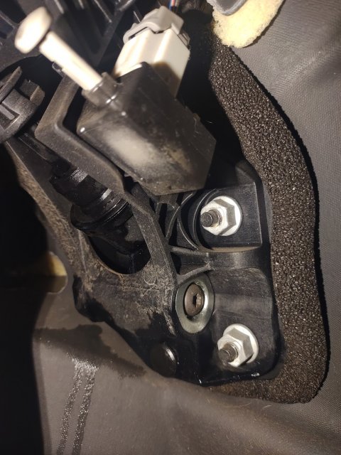

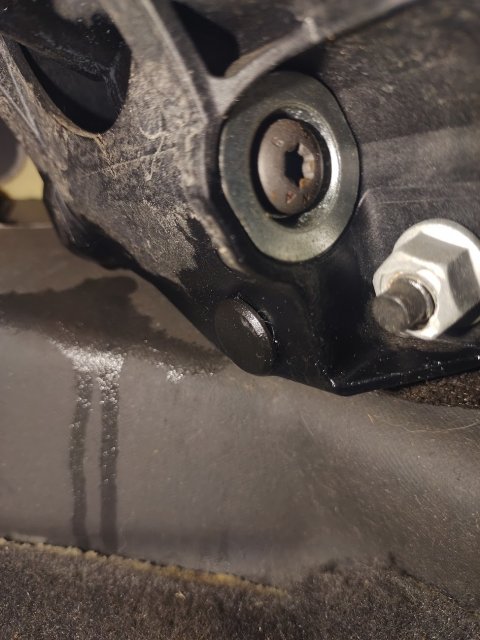

Brake fluid is dripping from the clutch master INSIDE of the car as pictured:
Would this be as simple as swapping in a new master cylinder and bleeding or am I looking at something big all together you guys think?

Yeah I saw the torx screws in there holding it together. It's actually not a.... Terrible design I dont think, the older models with it integral are sketchy though lol

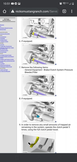

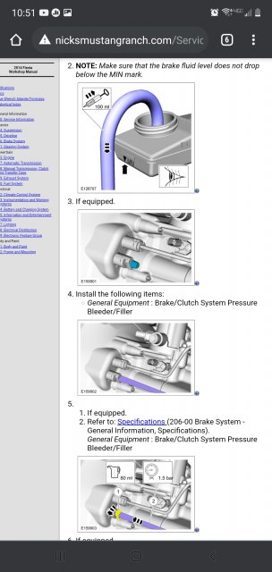

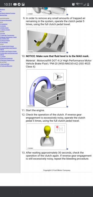

Reverse bleed the clutch took me 3 minutes and only had to do it once. And one person can do it. Screenshot_20210415-225101_Chrome.jpg Screenshot_20210415-225109_Chrome.jpg Screenshot_20210415-225117_Chrome.jpg
This is the tool I used to push fluid into the slave cylinder. Really don't need it you can just used a 20 oz bottle with hose attached with fluid in there.

Reverse bleed the clutch took me 3 minutes and only had to do it once. And one person can do it. View attachment 39778 View attachment 39779 View attachment 39780

No need to bench bleed anything.
Basically that is all.
Work gear shifter and test reverse. If you notice any grinding then remove some of the fluid in the reservoir and pump it full again.

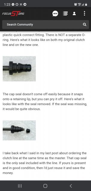

Yeah, just pushed the fluid through the new master cylinder from the slave cyl and hey presto no more issues.
The lower line from the master with that little seal did leak a biiiiiiiiit... but I got it sorted right.
The white plastic pin that hold the master to the pedal was a pain to push out too. but other than that. not a problem using that OEM tools syringe.
