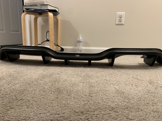

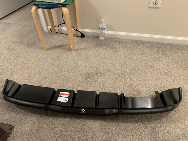

Hey guys I just received my Maxton Design read valence (diffuser) and it says on the piece to look up the instruction info for installation on their site but they do not have any instructions there apart for a Golf R. Has anyone had experience installing one of these before? I posted a pic as well. image.jpg image.jpg

Looks a lot like the Kamei aero kits from the '80s (and I mean that in a good way). Are there any pre-drilled holes on the underside?

Unfortunately not, I actually found a video online for the kit but the guy just retrofits it by drilling holes in the diffuser then drilling holes in the oem bumper. I wish the company gave any advice for where
I should drill the holes or if there is a specific method I should be doing.

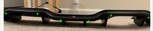

How about dimples? E.g, I bought a carbon fiber trunk lid for my previous car and nothing was pre-drilled -- but there were dimples, sometimes hard to recognize; maybe they're imprinted on the inside rather than the outside?
In any case, I'd think I'd want the attachment points near the "fins" and then on each of the most forward edges (which aren't visible in the picture) 1575950020298.png

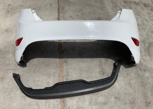

take the OE one off and it will be apparent where you need to drill. The OE until has only 2 holes on each end for pop rivets. You will need to drill out the rivets. The middle part is friction fit. No need to take the whole bumper off, you can remove the rear lower valance only. This is the only photo I have right now.
